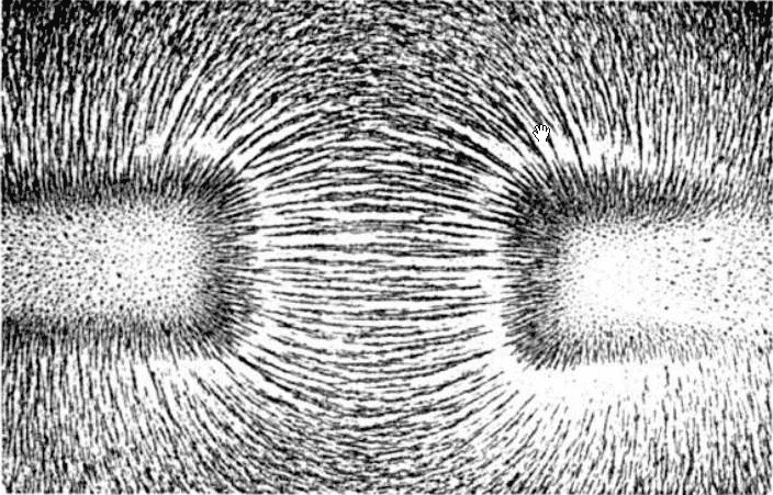

Hello all,
doing some reasoning and subsequent Gadenkin experiments, followed by a Non-scientific experiment results in some interesting changes in magnetic fields using glass lenses. Here it is, and please help me to explain this phenomenon, as I can find no mention of it anywhere.
Two bar magnets of equal size and strength.
One magnet has a convex glass lens adhered to each pole end.
One has no lenses.
Each magnet is suspended above a wood table (no metal anywhere near) using plastic shims.
A white card stock paper is laid over each magnet
Fine iron filings are sprinkled (as evenly as possible) from a shaker over the paper
The magnet with the lenses exhibits sharp deformation of fields, creating a well defined pattern significantly different from the norm, bending the field upward and to the sides of the lens and essentially removing the fields from the usual outward direction.
The magnet without the lenses, exhibits the familiar pattern usually associated with a bar magnet.
Remove the lenses from one magnet and apply to the other, and the same patterns are observed for the newly lensed magnet.
The effect extends greatly into the bar itself, up to a third of its length using the lenses I have. The effect changes when the lenses are changed and using a different magnitude lens.
I will be trying a concave shaped lens later, but wanted to post this for possible input on this result.

I know, it is a bit strange, but here it is. This could be a possible diamagnetic effect, but with two slightly different focal lengths of lenses, I get two slightly different patterns. The small horseshoe magnet is very weak, and that probably has something to do with what happened with it, and as I turned it so the side was facing up, I did see the lines in the pattern, but they disappeared from the top and bottom.
http://i679.photobucket.com/albums/vv152/GraviMag/MagneticFieldexperiments.jpg
I have tried plate glass, a chunk of lead pounded to the same shape as the lens, cardboard, gaff tape, ceramic, etc. No other material shows this type of pattern. I will be securing more lenses from a hobby store today and I will try them. I'll get plastic, glass, and even some glass that is not necessarily a lens but distorts light. If anyone else would like to try some things, please post the results, as this is baffling me when I refer to what I've been taught about magnetics.

yes, the pattern by themselves, still look similar to other by themselves, but when compared side by side, there is a definite difference as you can see in the image. I've tried to be as careful as possible to ensure that the top of the lens is not supporting the paper, even setting the lens just slightly lower, but the same pattern emerges. Like I said, when I put the lead in place of lens, the pattern looks like the magnet without lenses. Everything else I've tried also exhibits the non lensed pattern, so there must be something to the glass or shape of the glass.
Granted, this is not in a lab and I admit that a more stable environment is needed to test this, as well as new fresh magnets, different lenses, different materials, etc. But as the one who is looking at this strange effect, I am compelled to go forward and try everything that I can to cause this effect to fail with the lenses. Perhaps these lenses have a coating I am not aware of?

Sorry Gravitron, I don't see the difference you are talking about. As far as I can tell the field lines are in the same direction with and without the glass.
Well if you ignore the talk about field lines and just compare the overall look of the pattern the fileings make.
I don't know if anybody else concurs but both the magnets without lenses look similar as do both with lenses (they look like pairs).
However if you observe one with a lense and one without they do not look similar.

Yes but can you distiguish between the magnets with the lens attached and the ones without.
The ones with have a distinctive prickley pear look with the fileings distributed across the whole of the end of the magnets.
The magnets with no lenses attached, lack this distribution.
If you were to do a blind test it would be possible to recognise the magnets with lenses attached and the ones without.

Sure, but the "prickley pear look" does not indicate anything about the field. What it indicates is something about the initial state of the filings themselves and the setup. From a conceptual stand point, it is like you are making measurements with a ruler and then claiming you have measured a change in mass.

It could indicate something about about the setup then again it could be the field.
Certain variables about the setup would have to be eliminated to be sure.
Blackening the lenses before attaching them to the magnets to see if the "prickley pear look" persists.
Also different material of similar shape to the lenses could be substituted to eliminate the initial state of the setup.
If the field remains the same or very similar after these substitutions then it is the setup.
However if the field changes and the "prickley pear look" is no longer present then the lenses are somehowe effecting the field.

It took me some time to see it but it looks like the filings close to the poles are standing more upright ie pointing downwards towards the poles.As you move away from the poles and towards the centre the filings seem to become more horizontal.These are results I would expect but my eyes could be decieving me.
Sure, the field is 3 dimensional, and the direction of the filings does indicate the direction of the field at their location as I mentioned earlier. Do you think the filings indicate anything else about the field?

After many many experiment with different lenses of different substances, I can report the following.
1) out of all the lenses I've tried, the original lenses as posted were the only ones that caused this slight deflection of the pattern of iron fillings. All others were, as far as I could see, were identical to the pattern that was formed with just the magnet.
2) I could not find any information as to what specifically the lenses were made of, only that they were mass produced for use in LCD projector construction.
3) I used a diamond band saw to cut one of the lenses in half and as I polished the cut edge, noticed that there was some degradation of the glass in one area. After looking at this area in a microscope, i noticed that there was a small "pocket" in the glass. I assumed this was a bubble. After careful observation, I noticed many more of these pockets. I believe that these are bubbles in the glass, not noticeable to the naked eye. If these bubbles were filled with a gas, or even a vacuum then I would hypothesize that the magnetic field found it easier to go around these bubbles, thereby creating a slightly different pattern of the field. Is this possible?

First, it IS possible for an optical lens to have ferromagnetic contamination that is not noticed, or even concerned with, in it's use in BASIC optical applications, such as an LCD projector.
Even a standard piece of writing paper has trace amounts of iron, gold, plutonium, etc...
It would not surprise me at all that some manufactured lens' might have trace amounts of iron. Whether the amount and distribution is enough to cause an un-aided eye view of magnetic field distortion is another matter.

Importantly, however, without ferromagnetic contamination of some sort, a "pure" glass lens with or without bubbles WILL NOT distort a magnetic field, to my understanding, that is.
I don't think anyone ever mentioned it specifically before but your original reasoning is faulty. Lenses affect light by their affects on the electric field of the electromagnetic wave. They are designed to have permittivities that differ from the surrounding medium. The resulting boundary conditions only directly work on electric fields, magnetic fields are not influenced by permeabilities except for the fact that in an electromagnetic wave the two fields are now bound together. You should have no expectation that a lens affects a magnetic field unless, as pallidin mentioned, it contains extraneous contaminants that have non-vacuum permeabilities.
