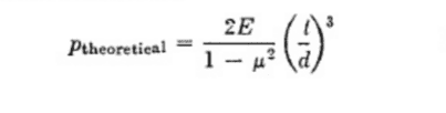

Well, one thing to check is buckling as well. I don't know the buckling load for a thin walled cylinder off the top of my head, but given how thin that result is, I suspect it'll be your limiting factor.
Likes Nidum
It does not even have to be fully developed buckling - any distortion which puts bending loads into the glass can be dangerous .
Design in any case should not be based on the maximum compressive strength of the glass - allowable stress for thickness calculations should be very much less than the maximum .

cjl, yes indeed. In another forum, an engineer warned the problem is buckling, not stress. Probably this is the reason for those unlikely numbers I got.
Nidum, by my readings so far, the glass will have an elastic distortion and suddenly will break (no plastic phase). So you are right about being far away from the limit, but some distortion will happen anyway.

Yesterday I found two references that use different formula. The thickness I found was now 2.7mm for:
E = 7 E +10 Pa
Pk = 1 E +5 Pa
u = 0.2
d = 0.3
The references are:
- Process Equipment Design - Lloyd E. Brownell, Edwin H. Young. John Wiley & Sons, Inc. (Chapter 8)
This paper makes a lot of sense too, since the project is using a brittle cylinder under external pressure.
- http://ieeexplore.ieee.org/xpl/login.jsp?tp=&arnumber=5603796&url=http%3A%2F%2Fieeexplore.ieee.org%2Fxpls%2Fabs_all.jsp%3Farnumber%3D5603796 - Shinichi Takagawa, University of Tokyo - IEEE 2010.
I hope I am on the right track now.
