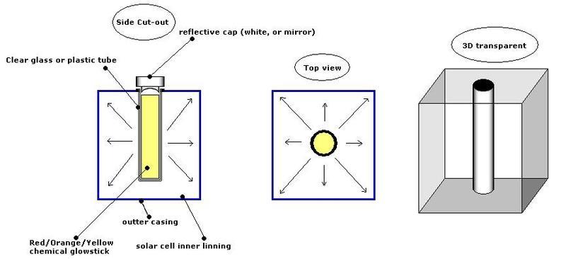

"GlowBox" <- going to work?
ok, here's the deal... I was watching my little bro play with a relatively small RC car and he was constantly having to rumage through the "junk drawer" for AA batteries, and he would find a few here and a few there and they would only run for 5-10 min (we didn't have any new batteries on hand)... and I was thinking to myself of alternative way of powering small devices like that, and this idea came to me:
I will be using a glowstick similar to this (https://www.sureglow.com/sg-store/catalog/images/yellow-glowstick-6.jpg )
Here's an explanation incase forgot something in the drawing:
- Basically you have a box with 5 whole solar cells, such as this one: (http://www.goldmine-elec-products.com/prodinfo.asp?number=G15236&variation=&aitem=16&mitem=31) or (5 and a partial cell at the top of the box near the tube opening)
- Next you have a small clear (glass\plastic) tube suspended from the top of the box and stays about 1-2cm from the bottom cell.
- Then, you line the seems between each solar cell with a thin white strip of some sort (to reflect as much light as possible) and have a reflective cap at the top of the tube to reflect as much light back into the chamber.
Then... when you place a chemical glowstick into the clear tube it will shine light onto the solar cells... pretty simple eh? ok, so what I'm wondering is whether the glowstick will provide enough power to the cells produce a significant amount of energy, I know that the solar cell in the above link cannot absorb blue & green light so I'm going to use pale yellow/orange ones. I don't have any definite dimensions for the glowsticks, or solar cells I will be using, but I was just wondering if anyone had any thoughts...?
So, basically this wouldn't really offer any power increases over traditional batteries, but rather address some issues with using them...
Advantages:
- Glowsticks themselves have an almost indefinite shelf life so no worring about how old they are
- Continuous operation for as long as the glowstick's chemicals are reacting and producing light (standard is about 8 hours... 6 to be safe)
- Glowsticks are relativly cheap when bought in bulk so for people who don't want to wait for their RC batteries to charge they can just pop in a 6-hour power supply.
Disadvantages:
- Once the glowstick dies... it's dead :\
- You can't stop the glowstick from glowing, so even when your not using it, it will continue to produce light and eventually die
- Unless you cover the cells in a hard cover (probly aluminum or thin plastic) they will be extremely vulnarable.
I just thought of this... maybe I could use multiple glowsticks spread out to pruduce more power... I would like to build one of these and test it out if you guys don't see any potential obstacles :smile:
Your biggest obstacle will be energy density, as in how much weight/size do you need to add to the RC car to get the same energy output as a battery.
Sounds like a good time for little brother to learn about charging batteries (which is cheap after initial purchase) and there are now plenty of choices for NiMH batteries in the AA size since digital camers have become so popular.

A few comments about the glowstick idea, aside from the energy density issue which Cliff mentioned. You seem to have got most covered though.
Glow sticks (at least where I come from) are expensive, I bet if you calculated some kind of cost-specific energy output, batteries of any kind would be orders of magnitude more favourable. Also, the last time I checked, they did have a shelf-life, - I remember seeing a use-by date stamped onto the packet.
Keep the ideas coming though joseph!
I see... I don't really think the energy density will be that big of an issue seeing as how it will basically be an empty box (for the most part) :P
And I'm sure glowsticks are made pretty much the same way anywhere you go and I don't doubt you've seen a "use by date" stamp on them, but I never have :\

If a radium dial watch had its own solar panel built in with specific tuning of absorbion to light you could power the solar cell with the radium already on the dial. there's still no good energy density.

how were you thinking of mounting the solar cells on the car becuase if you were putting them in the battery box you would probably need dimensions of about 3cm thick, 1cm high, and prbably 10cm long if you have 4 batteries lined up like this
l l
l l
