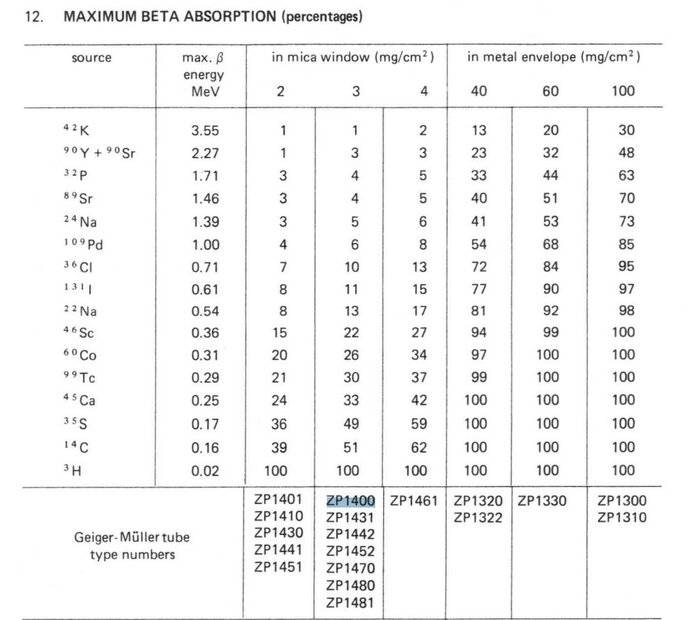

I am using an obsolete Philips 18504 or ZP1400 (one tube has 2 names, really strange, but it is what it is...)
So here is a picture from the datasheet.
,,A GM tube may only detect 1% of the gamma rays that go through it depending on the energy and construction, and making the metal shell thicker usually results in a tube that is a better gamma detector."
Can you explain the reason for that?

For a detector to be useful, the important question is not how many events it is detecting, or missing, but how many are out there and how accurately that can be estimated. That table gives information on what the tube can and can't detect and how much you would need to adjust the numbers to get the true answer.
GM tubes are usually made of thin materials so to be sensitive to beta rays etc. Gamma rays don't interact well, especially at high energy, so most will sail through the tube like it isn't there.
Hydrogen isn't a great way to detect neutrons (people that work with proton recoil counters may disagree), and putting wax in front of a GM tube with a window is highly inefficient, but a proton and a neutron have similar masses so when a neutron does hit a proton the maximum kinetic energy transfer can happen. If you are going to play marbles, you want it to hit another marble. A bowling ball would probably barely move, and you wouldn't expect a GM tube to detect neutrons normally.
