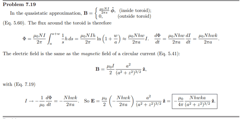

Ok, so I understand how to find dphi/dt that is integral of -d/dt(B "dot" da). In this case I find a Phi that is a constant in space in time which causes me confusion in next step.
Edit: dphi/dt is constant...
Grithff's then says E field same as a Mag field above center of circular current. He writes the B found from solving Biot-Savart for a ring with current I, and says that in this senecio I is equal to -1/mu dPhi/dt.
Firstly, how the heck am I supposed to know to make this substitution based on the textbook?Secondly, how does this make sense. How can I take a statement about EMF and faradays law that will gives me E dot dl of a closed loop and use that to find the E at any point in space. Especially, when the EMF is not a function of time or space!
I understand the idea that E field in this problem is equivalent to the B field in the prior problem. However, I can't explicitly understand how they are the same and I couldn't find any mathematical justification of there equivalence.
The current ##I## is changing with time. How can the flux be constant?

He explains all of this pretty clearly at the beginning of that section 7.2.2 (in the fourth edition). If ##\mathbf{E}## is a purely induced field, it satisfies the same equations as a magnetostatic field with ##\mu_0 \mathbf{J}## replaced by the ##-\partial_t \mathbf{B}##.

Wow! I have no idea how I missed that! That raises a different question though. If we have EQ 7.18 from section 7.2.2, then why in the solutions does Griffiths find phi first when EQ 7.18 only requires partial of B. Do I need to find phi?
The ##\partial_t B## is like the current density ##J##, but the magnetic field due to the loop depends on the current ##I##, which is analogous to the magnetic flux ##\Phi_B##.
