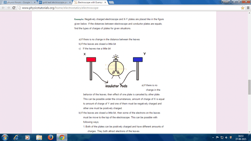

Negatively charged electroscope and X-Y plates are placed like in the figure given below. If the distances between electroscope and conductor plates are equals; find the types of charges of plates for given situations.
1)If the leaves are closed a little bit
2) If the leaves rise a little bit
___________
Answers of 1) is
1. Both of the plates can be positively charged and have different amounts of charges. They both attract electrons of the leaves.
2. They can have different charges; however, amount of positive charge must be larger than the negative charge. Since, there must be net positive charge to attract electrons from the leaves.
Should not there be third possibility i.e
3)Both of the plates can be positively charged and have same amount of charge
similarly Answers of 2) is
1.Both of the plates can be negatively charged and have different amounts of charges. They repel electrons from top of the electroscope to the leaves.
2.They can have different types of charges, but amount of negative charge must be larger than the amount of positive charge to repel electrons from top of the electroscope to the leaves.
3)Both of the plates can be negatively charged charged and have same amount of charge
Sorry for overlooking that ! Let me check.
I fully agree with you.
Likes gracy
And what about
3)Both of the plates can be negatively charged and have same amount of charge
quite obvious ?

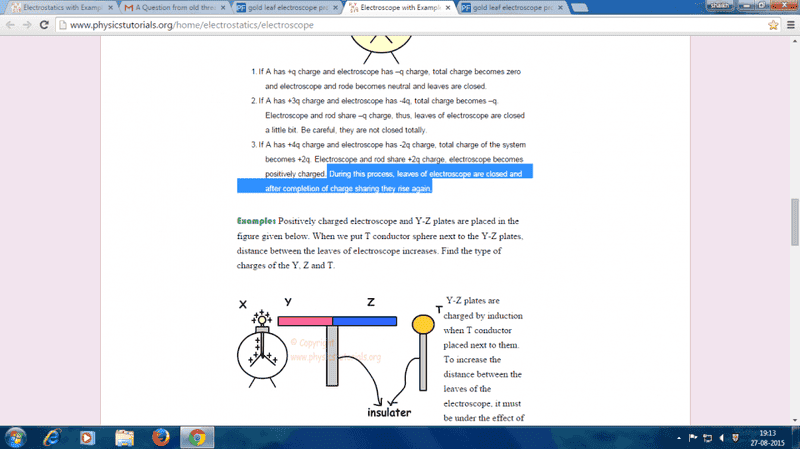

In the third point,it is written that "During this process, leaves of electroscope are closed and after completion of charge sharing they rise again".
Why the leaves of electroscope were closed earlier?
Same thing. They reason correctly that some electrons move towards the leaves. The only thing that is needed for that is some negative charge near the tip sphere of the electroscope. One negative, two negative (equal or not equal), one negative and one lesser charged positive, it doesn't matter.
It looks to me as if they wanted to ask and explain a little too much for this example.
Can't find an e-mail address for this club, otherwise you could point this out to them !

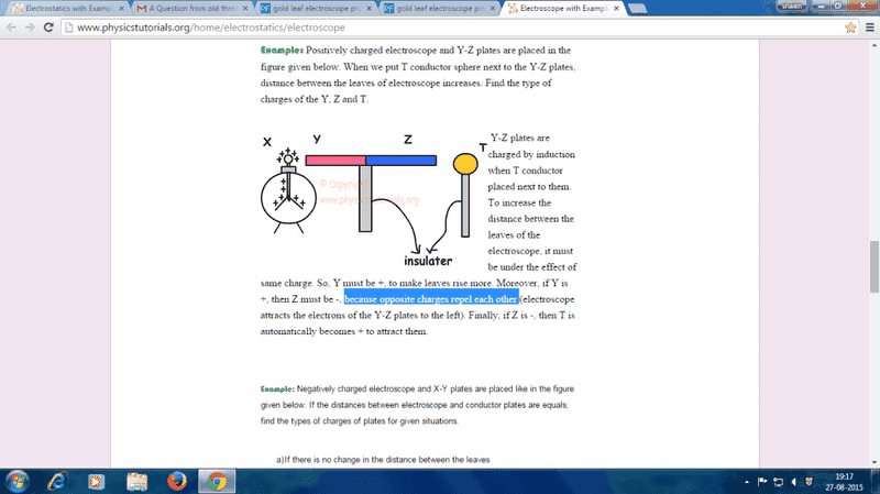

Similarly i have found another mistake on this particular page
Opposite charges repel?opposite !

For me (no expert in didactics, just a student long time ago) this is again not a very helpful exercise. But what it says is correct.
One can argue about details (formally Y is + and Z is - goes too far. All that can be concluded is that Y is more + than Z).
Opposite charges repel. That's correct. But the sentence
if Y is +, then Z must be -, because opposite charges repel each other
is gibberish.
My account:
If the leaves spread, positive charge must be pushed down the electroscope. So Y has become more postitive than before. YZ is on an insulator, so the total charge on YZ is constant. THerefore Z must have become less positive (= more negative) than before. That means T has pushed away positive charge from Z. Since pushing away is repelling that means T is positively charged.
I thought Opposite charges attract.
See ! You did manage to confuse me. Or rather, the PhysTut site managed that.
Of course you are right!
What happens is "YZ is on an insulator, so the total charge on YZ is constant. Therefore Z must have become less positive if Y has become more positive."
You're better than I in this, so keep up the good work !

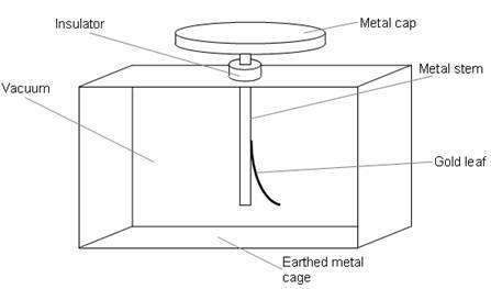

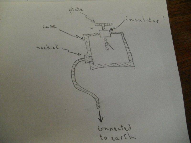

Ok. one more query about this gold leaf electroscope
when a negatively charged rod is brought near the cap of a gold leaf electroscope whose case is earthed then what will happen?
I think when a negatively charged rod is brought near the cap of a gold leaf electroscope cap,it will try to develop positive charge .so electrons from the cap will travel to gold leaves and in this way cap will develop induced positive charges and leaves would have induced negative charge (induced because rod has just been brought near not touched).But the question further says the cap case is earthed ,so it will be provided with electron from Earth and it will get neutral(as this is the purpose of earthing as far as I know).Then in this way the leaves would have negative charge ;which will be there forever ( permanently) I mean as it is not induced charge. I think induced charges are there for limited time as soon as we remove the inducing agent, the induced charges disappear.
I want to understand if the question says the case is earthed what actually is earthed?Is it case of cap or case of whole gold leaf electroscope?

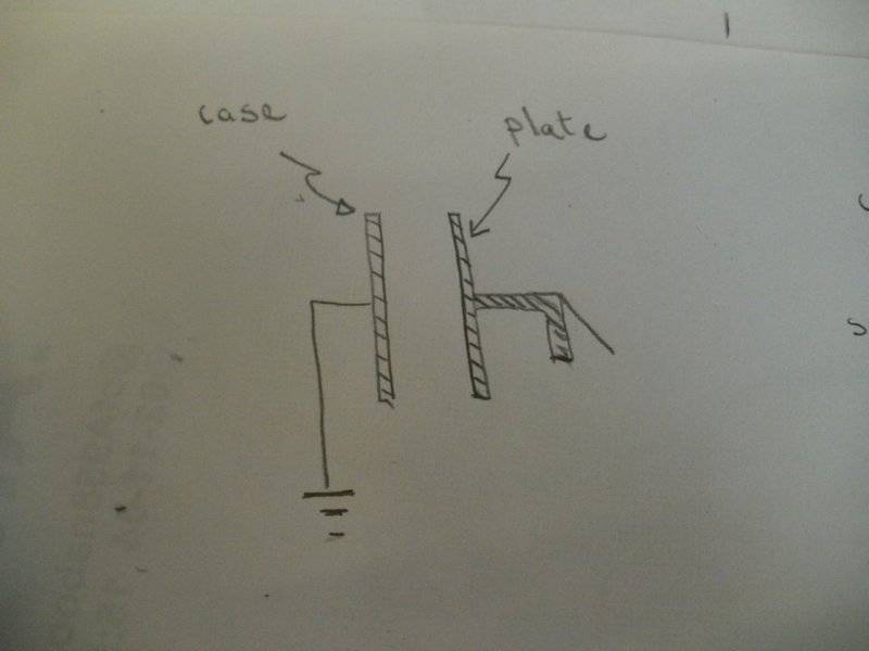

  • #32
when a negatively charged rod is brought near the cap of a gold leaf electroscope whose case is earthed then what will happen?answer is leaves will develop induced negative charge .but i don't understand why.as the leaves are earthed how it can have any charge?earthing is for neutralisation
  • #33
This is what I think will happen:
In this instance the case of the electroscope is earthed, not the leaves.
The rod will push the electrons off the case into Earth so that a positive
charge is induced on the case. It will also push electrons in the cap down
into the leaves so that they become negatively charged, but less than if
the case was not earthed.
  • #34
  • #35
This is what my teacher said on my question
My question:
Teacher answer :The case is the insulated box on top of which the cap is placed and inside which there are the leaves of metal. We need to Earth this case to ensure any charges on it which may lead to incorrect reading are neutralised.
