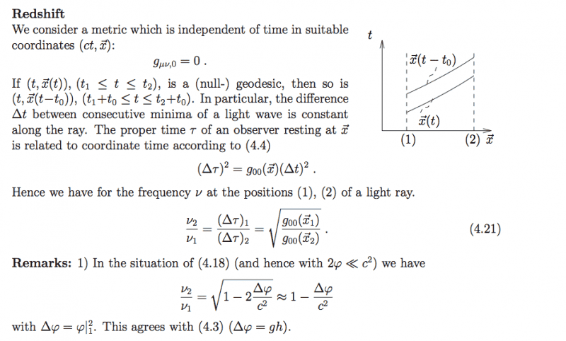

I also see I am missing something because of how some sources treat the case of redshift, this time due to the light escaping a gravitational field.
What they do is say: I have an observer at [itex]\vec x_1[/itex] which measures a coordinate time [itex]\Delta t_1[/itex] elapsing between adjacent crests in the wave. The proper time elapsed must then be [itex](\Delta \tau_1)^2=g_{00}(\vec x_1)(\Delta t)^2[/itex]. Then you write the same equation for an observer at [itex]\vec x_2[/itex] and what they do next is say [itex]\Delta t_1=\Delta t_2[/itex] hence getting [itex]\frac{\nu_2}{\nu_1}=\frac{\Delta \tau_1}{\Delta \tau_2}=\sqrt{\frac{g_{00}(\vec x_1)}{g_{00}(\vec x_2)}}[/itex]. But that is the exact opposite of what I would have done as to me it would have made sense to set the proper times equal to each other.
To me [itex]\nu_1=\frac{1}{\Delta t_1}[/itex] makes sense, while [itex]\nu_1=\frac{1}{\Delta \tau_1}[/itex] does not.
By the way another thing I don't understand is the notation [itex]g_{00}(\vec x_1)[/itex] and [itex]g_{00}(\vec x_2)[/itex] as if the two different values for the metric were assigned to two different points in one and the same tangent space. I would understand [itex]g_{00}(p_i)[/itex] were the p_i are points on the manifold.
Anyone can see where the hell I must be terribly wrong with my way of seeing things?
Let's suppose that
  1. The first crest passes [itex]\vec{x_1}[/itex] at time [itex]t_1[/itex].
  2. That crest passes [itex]\vec{x_2}[/itex] at time [itex]t_1'[/itex].
  3. The second crest passes [itex]\vec{x_1}[/itex] at time [itex]t_2[/itex]
  4. The second crest passes [itex]\vec{x_2}[/itex] at time [itex]t_2'[/itex]
If it takes a certain amount of time, [itex]\delta t_{12}[/itex] for light to pass from [itex]\vec{x_1}[/itex] to [itex]\vec{x_2}[/itex], then:
  • [itex]t_1' = t_1 + \delta t_{12}[/itex]
  • [itex]t_2' = t_2 + \delta t_{12}[/itex]
So subtracting gives:
[itex]t_2' - t_1' = t_2 - t_1[/itex]
So the coordinate time between crests is the same at both locations. But since proper time is not the same as coordinate time (and the conversion factor is location-dependent), the proper time between crests is different in the two locations.

I am not a priori against what you said but I don't get what the coordinates system [itex](t,x^0,x^1,x^2,x^3)[/itex] is supposed to describe. It cannot be coordinates on the tangent space because there are two different values for the metric at two locations [itex]\vec x_1[/itex] and [itex]\vec x_2[/itex]. Moreover in my head the conversion formula between proper time and coordinate time [itex](d\tau)^2=g_{ij}dx^idx^j[/itex] only applies between a fixed observer on a tangent space who measures a change in coordinates [itex]dx^i[/itex], and a moving observer, who travels along with whatever object has changed it's coordinates by the [itex]dx^i[/itex], and who's clock is going to measure [itex]d\tau[/itex].
I will attach a snapshot of this problem I found in a script, and if someone takes me by hand and tells me what there corresponds to what in the mathematics of curved manifolds and then what it means physically I would be very thankful. In particular what that aforementioned coordinate system is and who it is that would physically measure the time [itex]\Delta t[/itex] if it's not the time measured by the the observers fixed at [itex]\vec x[/itex]. (as seems to be mentioned there).
I am not sure what you mean by "locations [itex]\vec x_1[/itex] and [itex]\vec x_2[/itex]". Points on a manifold are not vectors, so I don't understand the notation.
danieron said:
This distance, which incidentally corresponds to the time a clock moving with the ball would measure , is going to be given by ##(\Delta \tau)^2=g_{ij}x^ix^j## where the g_ij's depend on where I am right?
It depends on what you mean by "my coordinate system". Since you appear to be saying that 1s of coordinate time corresponds to 1s of time elapsed on your clock, then the coordinates you are using must be local inertial coordinates in which you are at rest (assuming you are in free fall), which only cover a small patch of spacetime around a given event (in this case, the event of you firing the cannon). In these coordinates, the metric is always the same (the Minkowski metric ##\eta_{\mu \nu}## ), and if we assume that the cannonball is in free fall once it's fired and that it's always fired with the same velocity relative to you, then the coordinates it reaches after 1s will always be the same, regardles of where in spacetime you run the experiment. Differences in gravity won't affect this because they are all "factored out" by the use of a local inertial frame in which you are at rest.
If, OTOH, you are using some sort of global coordinates (such as Schwarzschild coordinates in the spacetime around a gravitating mass), then you can't assume that 1s of coordinate time is the same as 1s of "your" time (time elapsed on your clock). That means the conditions of the experiment are not specified well enough, because you can't measure the cannon ball's position after 1s of coordinate time unless you know the relationship between your clock's time and coordinate time, since you have to use your clock to measure time. See further comments below.
danieron said:
what that aforementioned coordinate system is and who it is that would physically measure the time ##\Delta t## if it's not the time measured by the the observers fixed at ##\vec x## .
The example you give is using global coordinates in a stationary spacetime (which means the metric does not depend on coordinate time). No observer at any finite ##\vec{x}## (this notation, btw, is not often used because, as DaleSpam pointed out, points on a manifold are not vectors, so thinking of spatial positions as vector displacements from some spatial origin is not a good idea) measures coordinate time in these coordinates; the coordinate time is just a bookkeeping device. Observers fixed at a given spatial position ##\vec{x}## measure their own proper time; however, a stationary spacetime has the property that there is a function ##\phi(\vec{x})## which gives the ratio of proper time to coordinate time for an observer fixed at ##\vec{x}##. The example you give is simplly illustrating that if you send a light signal between two spatial positions ##\vec{x}_1## and ##\vec{x}_2## which have different values of ##\phi##, the light will be redshifted or blueshifted, because, since the lapse of coordinate time ##t## between two wave crests or troughs is the same, the lapse of proper time for the two observers fixed at ##\vec{x}_1## and ##\vec{x}_2## must be different.
No. Coordinates are labels on points in space (or spacetime, in the case of relativity). A coordinate system assigns four numbers: [itex]x^0, x^1, x^2, x^3[/itex] to each event. A coordinate system defines "simultaneity" of two events: if they have the same value for [itex]x^0[/itex], then they are at the same "time". ([itex]t[/itex] is used interchangeably with [itex]x^0[/itex], usually).
...in my head the conversion formula between proper time and coordinate time [itex](d\tau)^2=g_{ij}dx^idx^j[/itex] only applies between a fixed observer on a tangent space who measures a change in coordinates [itex]dx^i[/itex], and a moving observer, who travels along with whatever object has changed it's coordinates by the [itex]dx^i[/itex], and who's clock is going to measure [itex]d\tau[/itex].
No. It doesn't have to do with "observers". If you have a clock that travels at constant velocity from the point with coordinates
[itex](x,y,z,t)[/itex] to the point [itex](x+\delta x, y+\delta y, z+\delta z, t+\delta t)[/itex], then the elapsed time on the clock changes by the amount
[itex]\delta \tau = \sqrt{g_{ij} \delta x^i \delta x^j}[/itex]
