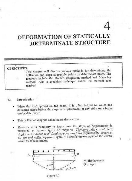

Gradient at roller and pin support
In summary, the author only stated that zero displacement occurs at the pin and roller support, but did not mention that the slope at these supports is also zero. The slope is maximum at the ends of the beam where the supports are located, not zero. The slope is minimum in the middle of the beam and only becomes zero at the center.
chetzread
801
in the notes , why did the author only stated that zero displacement occur at pin and roller support?
Why the author didnt stated that the slope at pin and roller support is also = 0 ?
As we can see from the figure, the gradient at pin and roller support = 0 ?
The slope is maximum at the ends of the beam, where the pin and roller are located, not zero.
Likes chetzread
why not = 0?
the slope is minimum in the middle of the beam, and 0 at the 2ends of beam, right?
The beam is sagging. Slope is zero only at the center of the beam. But at either end, slope is maximum.
