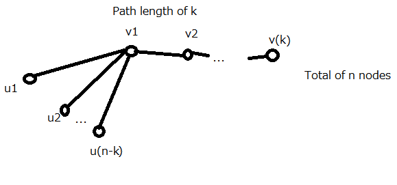

I need to prove the above statement. I have a very strong gut feeling that the above equation is not true, and so I need to find a case where the graph diameter is greater than the average pairwise distance.

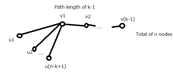

Hi, I have attempted and I am stuck at this part.
Fix $ k$. Consider G, with a path $v_{1},v_{2},...v_{k-1}$. Attach each node $u_{1},u_{2},...u_{n-(k-1)} $to $v_{1}$. This means we have attached $(n-k+1) $nodes to $v_{1}$.
$diam(G) = d(u_{1},v_{k-1}) = k-1$.
So the graph looks like this:
And now we need to find the maximum value for apd(G). How can we find the sum of the distance of all the vertices? I know for sure that there will definitely be an element from $v_{1},v_{2},...v_{k-1}$ since the distance must be at least 1.
Let me edit that! I feel like I could be using better values instead.
Fix $ k$ Consider G, with a path $ v_{1},v_{2},...v_{k}$ Attach each node $ u_{1},u_{2},...u_{n-k}$ to $ v_{1}$. This means we have attached $ (n-k)$ nodes to $v_{1}$.
$diam(G) = d(u_{1},v_{k-1}) = k$.
And now we need to find the maximum value for apd(G). How can we find the sum of the distance of all the vertices? I know for sure that there will definitely be an element from $v_{1},v_{2},...v_{k}$ since the distance must be at least 1.
I changed the $(k-1)$ to $k$ instead, in turn changing $diam(G)$ to $k$ as I think it would make things easier. Let me attempt to find the maximum value of $apd(G)$, please correct me if I'm wrong.
We want the sum of all the distance between u and v, for all u, v that exists in G. So there are $C(n,2)$ pairs. Each of these pairs has a distance of at most $k$. Therefore, the sum is $C(n,2) * k$
By the $apd(G)$ formula, $\frac{C(n,2) * k}{C(n,2)} = k $
Therefore, we have that $\frac{diam(G)}{apd(G)} > 1 $
