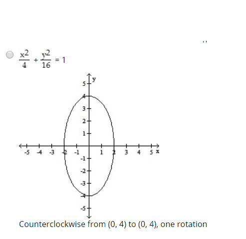

Parametric equations and a parameter interval for the motion of a particle in the xy-plane are given. Identify the particle's path by finding a Cartesian equation for it. Graph the Cartesian equation. Indicate the portion of the graph traced by the particle and the direction of motion.
x = 2 sin t, y = 4 cos t, 0 ≤ t ≤ 2π
##cos^2t + sin^2t=1##
## x= 2 sin t ##
## y = 4 cos t ##
Square both sides :
## \frac{x^2}{4} = sin t^2 ##
## \frac{y^2}{16} = cos^2 t ##
Add the two equations :
## \frac{y^2}{16} + \frac{x^2}{4} = 1 ##
This equation forms an ellipse.
When t = 0 , x = 0 and y = 4
When t = ##2\pi## , x = 0 and y = 4
Counterclockwise from (0,4) to (0,4) , one rotation .
Could someone check my answer ?

Looks good, except for a small typo. After you square both sides, it should be ## \frac{x^2}{4} = sin^2 t ##, not ##sin t^2##
