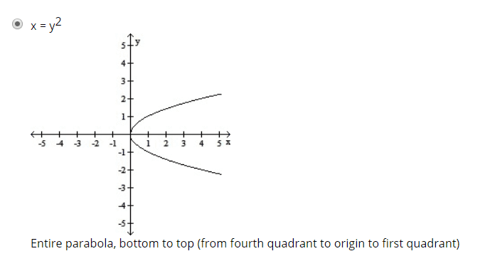

Parametric equations and a parameter interval for the motion of a particle in the xy-plane are given. Identify the particle's path by finding a Cartesian equation for it. Graph the Cartesian equation. Indicate the portion of the graph traced by the particle and the direction of motion.
(1)##x = 4t^2##
(2) ##y = 2t## , ## - \infty ≤ t ≤ \infty##
Square the second equation :
##y^2 = 4 t^2 ## (3)
Subtract (3) - (1):
##y^2 - x = 0 ##
##y^2 = x##
This equation forms a parabola .
When ##t = - 1 ## , ##x=4## and ##y=-2##
When ## t = 1 ## , ##x = 4## and ##y=2 ##
From bottom to top.
Is my answer correct ?

Looks good!
Likes Fatima Hasan
Yes, it is. I'm not quite sure what is meant by "Indicate the portion of the graph traced by the particle", but I assume it is the parabola itself.
