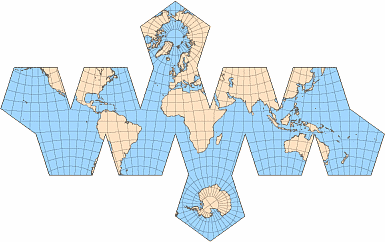

Your platonic solids reference gave me an idea that mgiht simplify things.
If an actual graphic (containing lines) ends up being too much effort, I think I might settle for just a twenty, or merely a dozen, points, distributed around the Earth.
So, if I were to calculate my coords at the vertices of a icosahedron or even merely a dodecahedron that would be sufficient.
This would be perfect, though I'd like to find one with Russia nearer the cetnre. (or rearrange this one).
I'd still need to figure out the angles (through the solid) from vertex to vertex.

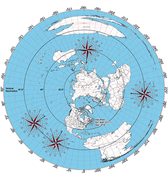

Wow. That is absulotely perfect!
Thank you!
I have only one thing left to do now, which is determine the angle of declination at the latitudes.
Angle X:
http://www.mathwarehouse.com/geometry/circle/angle-tangent-and-chord.php
There are only 3 azimuthal latitudes the mapmaker generates: 45, equator and -45, so this should be easy.
So...
A⊕C = 45°: X = ?
A⊕C = 90°: X= ?
A⊕C = 135°: X= ?
(where ⊕ is the centre)
Looking over the exercises, I think I can flip tje calculation.
Is it as simple as halving the arc angle?
A⊕C = 45°: X = 22.5
A⊕C = 90°: X= 45
A⊕C = 135°: X= 67.5
Well, A⊕C = 90°: X= 45 works out correctly, since it would form a right triangle, so that's good.
Perfect!
I still have to estimate both declination angle and direction but it's pretty straightforward now.
Oh, and I guess I should put some instructions for doing so...
LaurieMD said:
http://wdc.kugi.kyoto-u.ac.jp/index.html
I like the map above!
Found a link to add some data...if you want your compasses to be exact! :)

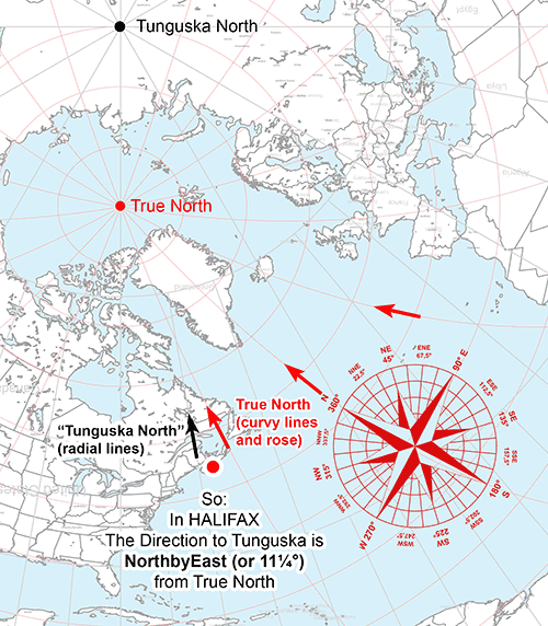

Thanks but I've actually corrupted the compass roses. The roses - and all the red lines are not magnetic; they're actually geographic/true. (i,e, they point to the true geo poles)
So, I can reference my new fabricated grid (the straight, radial grey lines) and say "at location X on Earth, a straight line running to "Tunguska North" is x degrees off from True geo North (the red curves)".
Halifax is the only point referenced on the map. From Halifax, an arrow that points directly to "Tunguska North (the straight radial grey line) will actually point 11.25 degrees East of True North (the curvy red lines).
Here is a closeup of Halifax:
