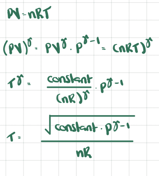

My question is about what this means graphically, especially in comparison with a quasi-static isothermal process.
In the latter, we have ##P=\frac{nRT}{V}## and
$$\left (\frac{\partial P}{\partial V}\right )_T=\frac{-nRT}{V^2}=-\frac{P}{V}>-\gamma \frac{P}{V}\tag{17}$$
which simply tells us that at any point ##P, V## in a ##PV## plot, the slope at that point of the adiabatic process passing through that point is more negative than the slope at that point of the isothermal process passing through that point.
Consider the following pictorial depiction
An isothermal process is represented by points on a curve that has all points at the same temperature (a dashed line above).
An adiabatic process seems to be represented by the solid lines. These are points that have varying ##P, V##, and ##T##.
Yet all we derived was equation (16). How do we know exactly what is happening to ##T##?
Is the answer simply obtained from the ideal gas equation ##PV=nRT##?
Ie, is it true that

In thermodynamics, we discard the definition of Cv in terms of Q and define Cv exclusively in terms of the partial derivative of U with respect to T at constant V. In that way,, Cv does not depend on the path function Q, but only depends on the state function U, so that Cv is a physical property of the gas. The same goes for Cp in terms of H. Furthermore, for an ideal gas, U and P are functions only of temperature T, and not P or V. So, for an Adiabatic reversible Process of an ideal gas, $$dU=nC_vdT=-PdV$$
Regarding ##PV^{\gamma}=C##, we can take the natural log of both sides and differentiate to obtain: $$\frac{dP}{P}+\gamma\frac{dV}{V}=0$$ Doing the same with the ideal gas law gives: $$\frac{dP}{P}+\frac{dV}{V}=\frac{dT}{T}$$Eliminating ##\frac{dV}{V}## between these equations gives. $$\frac{dT}{T}=\left(1-\frac{1}{\gamma}\right)\frac{dP}{P}$$or $$T=Const\ P^{\frac{\gamma-1}{\gamma}}$$
