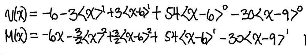

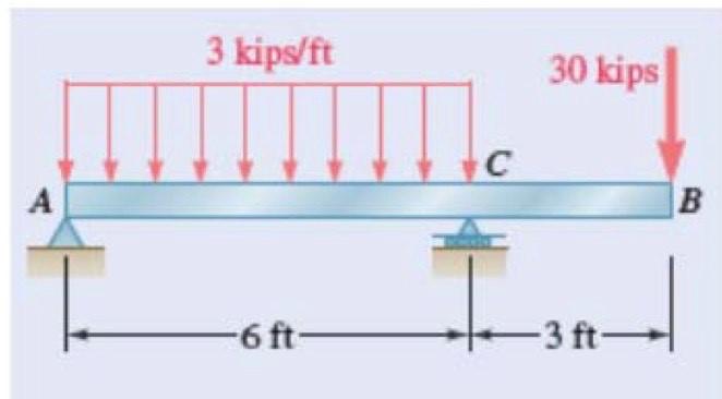

By Using singuarity function and Excel, plot shear and moment diagrams of the beam.
Shear and moment singuarity function
I had found the singuarity function for the shear and moment. I have a hard time calculating the singuarity function and graphing it using excel. Can anyone explain how to calculate singuarity function and graphing it using excel?
Many thanks for your help

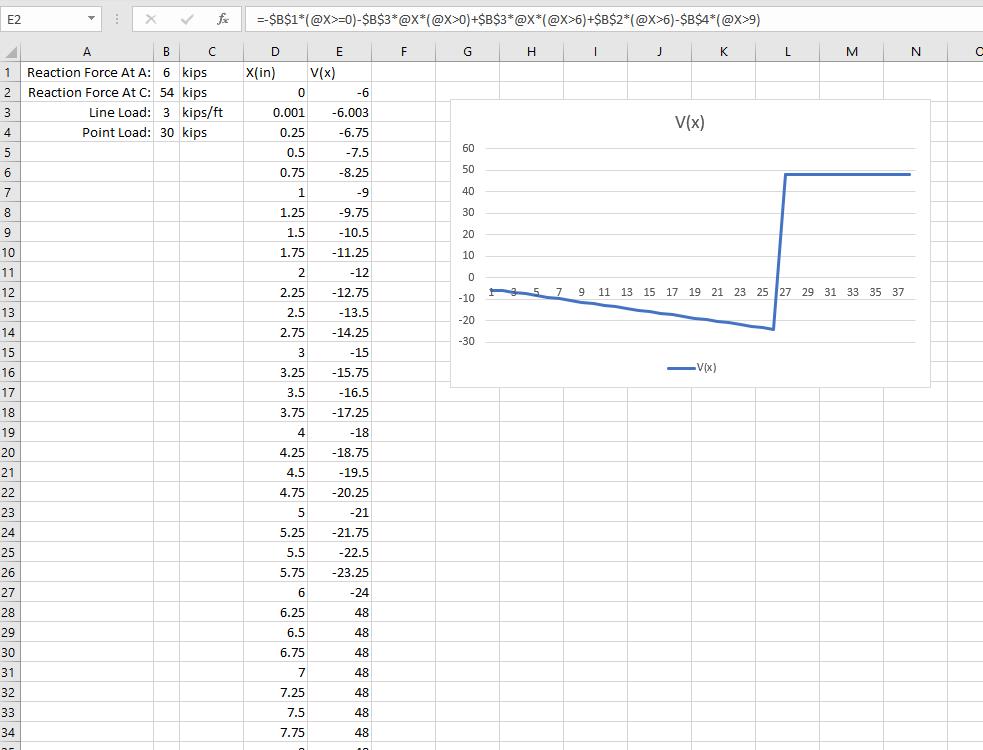

This is what I have done so far. Everything seems correct When X<6. When X>6, the calculation is wrong.The Shear force should be 30 kips. However, in Excel it was 48 kips.Could anyone tell what is wrong with my equation?
Many thanks for your help.
