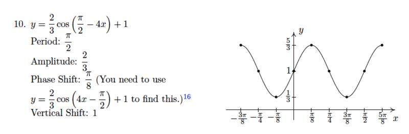

(1) y = (⅔) cos ( 4x - (π/2) ) + 1
Period: 2π / 4 = π / 2
Amplitude: ⅔
Phase shift: - ( -π/2) / (4) = π / 8
Vertical shift: 1
So to graph the authors have chosen the following values of x:
• π / 8 is chosen as the first x value, because, I presume, we should start the cycle at the point of the phase shift (of course, we can start the cycle anywhere, but here the task is to practice graphs' shifts);
• next x value π/8 + π/8 = π/4;
• next x value π/4 + π/8 = 3π/8;
• next x value 3π/8 + π/8 = π/2;
• next x value π/2 + π/8 = 5π/8;
at this point we finished one cycle with π/2 period, which started at π/8 and finished at 5π/8
Therefore each x value is increased by π/8, which happens to be the value of the phase shift.

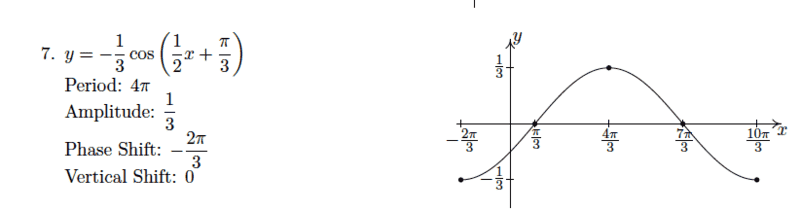

(2) y = (-⅓) cos ( (½) x + (π/3) )
Period: 2π / (½) = 4π
Amplitude: 1/3
Phase shift: - ( π/3) / (1/2) = -2π / 3
Vertical shift: 0
• -2π / 3 is chosen as the first x value;
• next x value -2π / 3 + π = π/3;
• next x value π/3 + π = 4π/3;
• next x value 4π/3 + π = 7π/3;
• next x value 7π/3 + π = 10π/3;
at this point we finished one cycle with 4π period, which started at -2π/3 and finished at 10π/3
Therefore each x value is increased by π, which happens to be the value of the phase shift.
I don't see how they choose the pattern which determines the x values.

A zero of cosine is at π/2. Set the input of cos equal to π/2 and solve for x.
Likewise and a maximum is at 0. Set the input of cos equal to 0 and solve for x.
Those will give you some good x values to use.
Thank you! You reminded me that to find the x values I have to equate angles's values (those in brackets for cos or sin) to 0, π/2, π, etc values to get suitable x values for the graph. :)
