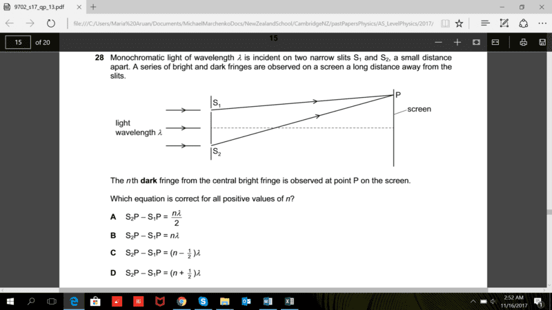

I can exclude B because B shows maxima, but I do not know how to exclude A and D.
These are the equations for the diffraction grating and the double-slit experiment:
dSin(A) = nL
DL = ax
It seems that this problem is about the combination of both.
C is probably the correct answer.

For ## A ##, what do you get if ## n ## is even? ## \\ ## Editing: The answers really needs absolute value signs and should be written ## |S_2P-S_1P|=... ## Then it will work for the ## nth ## dark fringe counted from the center up or down. To determine whether the correct answer is ## C ## or ## D ##, what do you get for the first (## n=1 ##) dark fringe (up or down) from the center? Does it obey ## C) ## ## |S_2P-S_1P|=(1/2) \lambda ##, or ## D) ## ## |S_2P-S_1P|=(3/2) \lambda ##? ## \\ ## Additional item: Please use the homework template in the future for your homework problems.
