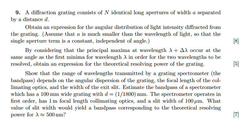

Part (a): Find intensity distribution of N-slit grating
Part (b): Find resolving power
Part (c): Find an expression for Bandpass, and estimate its value. What value of slit width gives same bandpass as resolving power theoretically?
I've solved most parts of the question, except the very last part in part (c). I thought the bandpass is independent of wavelength?Part(a)
[tex]I = I_0 \frac{sin^2(\frac{Nkd sin \theta}{2})}{sin^2 \frac{kd sin \theta}{2}} sinc^2 (\frac{ka sin \theta}{2}) [/tex]
Part (b)
Width from central maxima to first minimum ## \Delta \theta = \frac{1}{N}(\frac{\lambda}{d})##
For pth order fringe maximum: ## sin \theta_{max} = \frac{p\lambda}{d}##, I get angular dispersion as ##\frac{d\theta}{d\lambda} = \frac{p}{d cos \theta} \approx \frac{p}{d}##.
Thus, Resolving Power ##\frac{\lambda}{\Delta \lambda} = \frac{\lambda}{\Delta \theta / \frac{d\theta}{d\lambda}} = Np = N## for p = 1.
Part (c)
Bandpass is defined as the amount of lambda it let's through, so Bandpass is:
[tex] \frac{d\lambda}{d\theta} \Delta \theta[/tex]
[tex] = \frac{d\lambda}{d\theta} \frac{w}{f}[/tex]
Where w is exit path width and f is focal length.
I found bandpass = ##5.56 * 10^{-5} m##
Now for the last part, theoretically for first order resolving power is independent of λ?
Resolving power = N
[tex]\frac{wd}{f} = N[/tex]
[tex] w = 3*10^{11} m [/tex]
This answer seems ridiculous.
