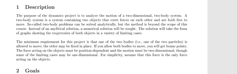

1. Homework Statement
You left out part 1. For a reason ?

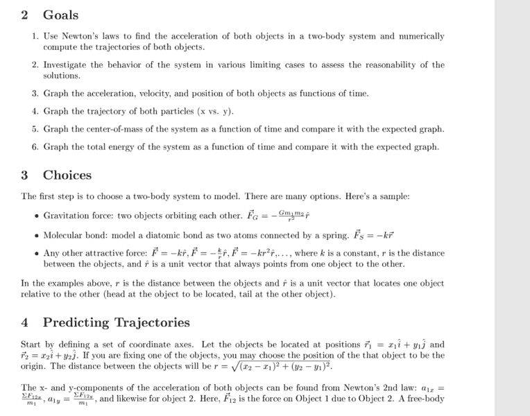

Re 3. Choices: You pick Earth and moon. OK, fine. You pick Earth as not moving ? Not so good ! Why do you think we have high tide twice a day ?

From your posting of part 1 it is clear the exercise doesn't want you to have only one body moving. (Good thing I remarked on that)
Earth/moon system is well known, so start with (looking up or calcualting) reasonable starting values: radial positions and tangential velocities.
You need to keep track of 2 positions and 2 velocities. Force is radial, so angular momentum is conserved.

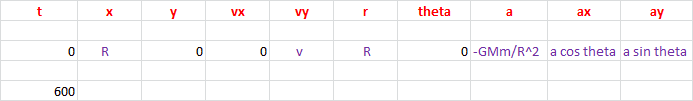

Now i will need to determine my dx and dy values for the moon rotating around the fixed point 0,0
i have my velocity as roughly 32000km/h
i cannot use trig functions here so i think i may have to start with an arbitrary x and y coordinate for the moon. rather than trig function i can use
dx = 32000*(x/R)
dy = 32000*(y/R)
my time intervals are every ten minutes
Currently stuck, thinking
As I said, R and v alone are not enough.
From $${GMm\over R^2} = {\ mv^2\over R}\quad ?$$
You can check it by calculating how long one month is
Now your integration:
Start in the xy plane with moon at ##(R, 0)## velocity ##(0, v_y)##
(with ##v_y## a better value that what you have now :rolleyes:)​
(the pink ones you stil have to calculate)
and at t = 600:
the new x ##\ ## is the x ##\ ## just above + vx * dt
the new y ##\ ## is the y ##\ ## just above + vy * dt
the new vx is the vx just above + ax * dt
the new vy is the vy just above + ay * dt
and the other ones you calculate​
this is called Euler integration. See where you end up after a month...

ok let me try again thank you for coming back be right back
my prof said i cannot use angles i must use x/r y/r which is what i think you mean
I'm off to bed -- after midnight here and early rise ahead.
Your time steps have a problem too.
Tip: use a formula, preferably a defined name (Create from selection on the formulas tab)

I am confused about the a column, i am getting an acceleration that doesn't make sense with an exponent of 10^26
So i have the acceleration formula now, do i have to integrate this formula here?

1018 m/s is what I get too.
On earth, g = 9.81 m/s2 So out there it should be a lot less.
Can't read you formula, but it looks as if it calculates a force ?
Keep track of R too. If you see it change very rapidly, it's a bug.
Keep track of theta too. It should evolve approximately linearly
yes you should integrate ax to get vx and ay to get vy. So you need to keep track of those.
And integrate vx to get x and vy to get y according to the
BvU said:
and at t = 600:
the new x is the x just above + vx * dt
the new y is the y just above + vy * dt
