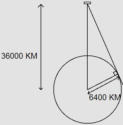

Please someone help me to understand the question

Geostationary satellites have a specific orbital radius, and orbit in a particular plane. The Earth is spherical. As you travel northwards (or southwards), at what colatitude will the satellite drop below the viewing horizon?
So which angle are we talking about?
Hi gneill
can you mark the angle we are talking about in the image
its really getting hard for me to understand
is it this angle ? ...
viz sin-1(.15)
See attached.
