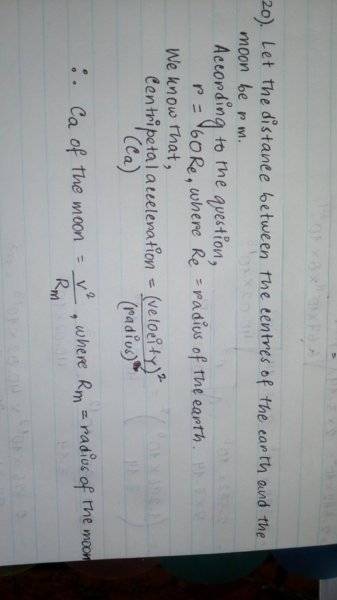

The distance between the centres of the Earth and the moon is 60 times the radius of the earth. Calculate the centripetal acceleration of the moon. Acceleration due to gravity on the Earth's surface is 10m/s.
Centripetal acceleration= v^2/R
Orbital Velocity=√2gR/√2
I found out the centripetal acceleration of Earth but I cannot find that of the moon.

MathLover69 said:
Firstly, notice that they did not give you the mass of the earth(Me) which is necessary if you want to find the acceleration due to the Earth's G-Field.
a = GME/r^2
However, you don't need the actual mass of the Earth since a is proportional to r^(-2) (a = kr^(-2)). Hope this helped. :)
P.S. This is all assuming that the G-Field of the moon is negligible for an object on Earth's surface.
Umm, I'm sorry...can you just elaborate on the answer, like how to find the a?? I'm confused a bit...
The centripetal acceleration of the moon equals the gravitational acceleration of the Earth's gravitational field at distance ##r=R_m=60R_e##.
The gravitational acceleration of Earth's gravitational field at distance ##r=R_e## (that is at the surface of the earth) is given equal to ##10m/s^2##
The gravitational acceleration of the Earth's gravitational field at a specific distance r is given by ##a_r=\frac{GM_e}{r^2}##. Apply this equation first for ##r=R_e ## and then for ##r=R_m=60R_e##. So you ll get two equations. Divide the two equations by parts, the ##GM_e## will be simplified, and you ll get an equation with only one unknown, ##a_{R_m}## that is the gravitational acceleration due to Earth's gravitational field at distance ##r=R_m##.
Thanks a ton! It helped a lot :)

@Urmi, in future, please be advised that you cannot post images of handwritten equations. You need to use the PF LaTeX feature to post math directly in the thread. See here for help:
https://www.physicsforums.com/help/latexhelp/
Okayy, I'm new here so I never knew this...I'll be sure to use this next time :)
