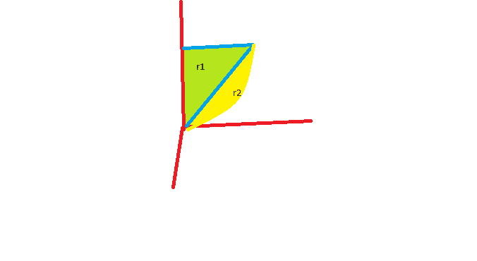

Find the gravitational attraction of a solid hemisphere of radius a anddensity1 on a unit point mass placed at its pole.
My attempt:
Obviously I figured that spherical coordinates would work nicely for this problem.
I decided to invert the hemisphere thus placing the pole on the origin. Then I decided to split the upside down quarter disc into two integrals. The first integral was then for a cone shaped figure (r1 in the picture i made).
I set it up as follows
[itex] G \int_{\vartheta=0}^{2\pi} \int_{
\varphi=0}^{\pi/3}\int_{\rho=0}^{a/sin(\phi)} sin(\phi)cos(\phi)d\phi d\rho d\theta[/itex]
Plz let me know if i have made any mistakes with the above integrand (pi/3 is where a cone will intersect a circle of equal radius).
However I could not manage to think up the equation (in spherical coordinates) for the lower circular bound. I considered changing coordinate systems for the outer spherical part but setting up the equation for force of gravity might have been tricky. Any help will be greatly appreciated.
well it would be given as the field due to the total mass within a gaussian surface through the point as if all that mass were concentrated at the center of mass.
Note: you can make your life easier by exploiting the symmetry even further - can you find the field at a perpendicular distance r from a disk radius R and thickness dz?
Yes I could but were looking for the gravitational attraction on the surface of the pole since that is where the unit mass is placed, or am i misinterpreting you?
You sort-of have ... if you orient the hemesphere so it's axis is the z axis, and slice it into disks thickness dz, then the biggest disk (the base) will be distance R from the test mass.
I just have a feeling you've not got one of the limits right ... one of the advantages of the slice method is that you can conceptually check each stage. Still - run with what you are comfy with ;)
