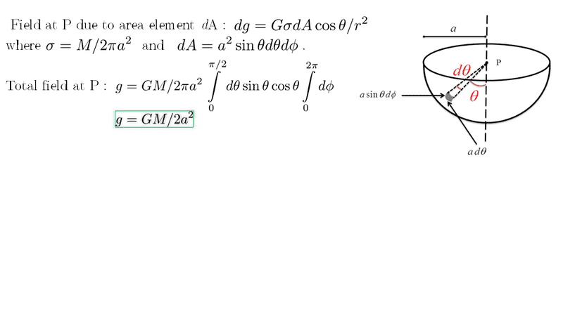

Please see the attached file if I have calculated the gravitational field g at the centre of a hemisphere correctly.
