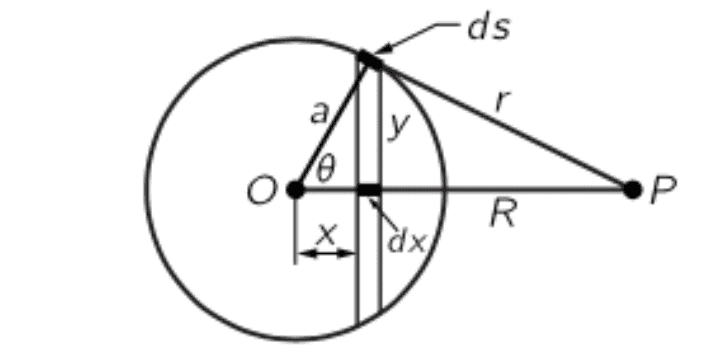

Why the area of the thin rings are ##2πasin\theta \, ds##? (a is the radius of the hollow sphere)
If we look from a little bit different way, the ring can be viewed as a thin trapezoid that has the same base length ( ##2πa sin\theta##), and the legs are ## ds##.
The angle between the leg and the lower base is ##90-\theta##. Hence,we can conclude that the height of the trapezoid is ##ds \, sin\theta##.
Since the base length is more or less the same, the area is just base x height.
This means, the area is :##2πa sin\theta \, ds \, sin \theta##.
Why don't you substitute ##ds=a~d\theta##, then integrate your area element over ##\theta## from ##0## to ##\pi##. Do you get ##4\pi a^2## for the area of the shell?
Yes.
But, ##ds## is not the height of the trapezoid. So, in my opinion, we are not supposed to multiply this with the ##2πa sin\theta## to get the area.
Rikudo said:
the height of the trapezoid is dssinθ.
Sure, but the height of the trapezoid is not what you need. A wall length L and height H has area LH. If it then leans over at angle θ it still has area HL, not HL cos(θ).

Umm... well, it is is true, but what is the relation of it with the area of ring?
Why, though? We can't use ##ds## as its height since it is not perpendicular to the bases.
@Rikudo, I suspect your difficulty arises because you are not 'visualising' the infinitessimal 3D strip correctly.
The line element ##ds## is perpendicular to both the inner and outer edges of the strip. That means the (infinitessimal) strip has the same area as a rectangle measuring ##2\pi a \sin \theta## by ##ds##.
