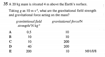

A 20 kg mass is situated 4m above the Earth's surface
Taking g as 10 m/s2. What are the gravitational field strength and gravitational force acting on the mass?
Am I wrong when I say that because the height of the mass ( which is 4m) is too little comparing with the radius of the Earth so that the gravitational field strength is equal to the free fall acceleration? My answer key said that not 10 but 40 is the right answer. Can anybody explain to me why the answer is 40?

Either there's something wrong with the answer or you have not conveyed the question correctly.
Can you post an image of the question?

There you are.

And what is your answer key saying is correct?
Then it is clear that the answer key is simply wrong. It should say C, not D.

It is D

As haruspex said, it is C. It cannot be D since g is the gravitational field strength and therefore must be 10 m/s^2.

The gravitational field strength of the Earth is g.
The Universal Gravitational Constant is G.
g in your problem is acceleration (m/s^2)
If you calculate the gravitational field strength near the surface of the Earth utilizing G you get g, or approximately 10 m/s/s. The Earth is so large and its mass is so great that being just a small distance from the surface or being an object of relatively small mass (compared to the earth) has practically no effect on the gravitational field strength. but forces rely on masses being accelerated, soo... if Force = mass * acceleration and our acceleration is g (or 10 m/s/s) then your force is the mass (20kg) * g (10 m/s/s) or 200 N
