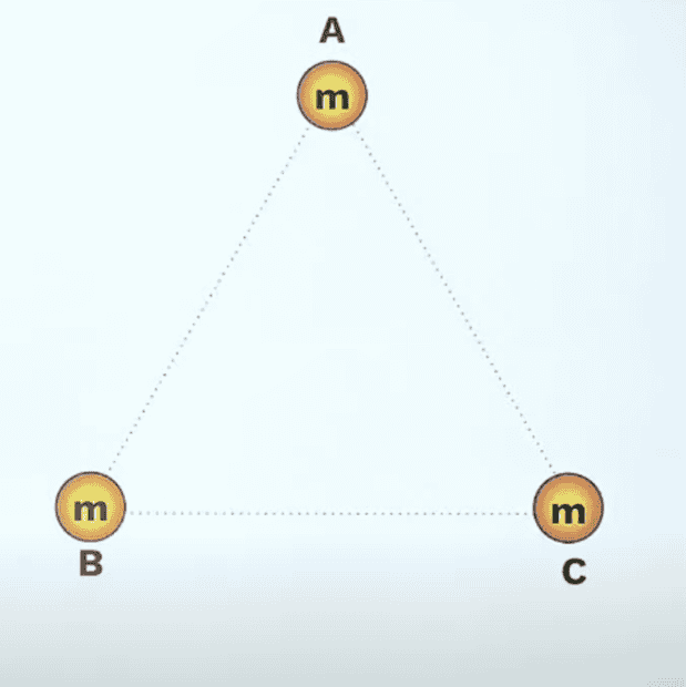

Three identical masses m are kept at the vertices of equilateral triangle of side 'a'. Find the force on A due to B and C
F =\frac{Gm_{1}m_{2}}{r^2}
I solved the math using vector rule
R= \sqrt{F^2 +F^2 +2F^2cos\frac{\pi}{3}} =\sqrt{3}\frac{Gm^2}{a^2}
But the answer is showing: \sqrt{3}\frac{Gm^2}{a^2} (-\hat{j})
My question is:
Why is (-\hat{j}) added here? Why is it negative?
We would need to know the positions of the masses in terms of the coordinate system.
That's not what I asked for, but the given answer seems to be assuming that ##\hat j## is straight up the page in that diagram. If you were not told that then I do not see how you could be expected to get that answer.
@hasibx you do not seem to understand what it means to
WHERE do the points sit relative to the x-y coordinates?
