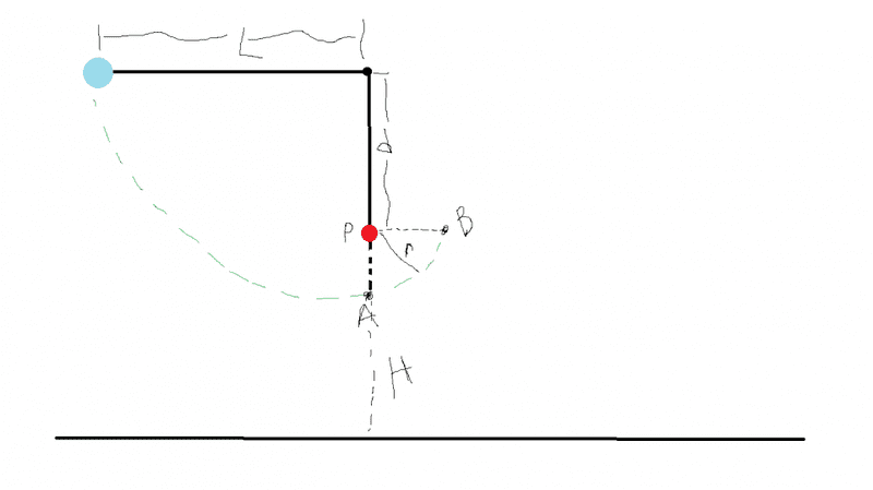

In summary, the string with a ball attached to one end and fixed at the other end has a length of 120 cm. When released from a horizontal position, the ball will swing along a dashed arc, with a distance of 75.0 cm to a fixed peg at point P. Using the equations ##-ΔU=W## and ##W=\frac 1 2 m((v_f)^2-(v_i)^2)##, the speed of the ball at its lowest point is 4.85 m/s and at its highest point is 3.83 m/s. However, the book states the speed at the highest point to be 2.42 m/s, as the highest point is

The string (in the pic) is L=120 cm long,has a ball attached to one end,and is fixed as its other end.The distance d from the fixed point end to a fixed peg at point P is 75.0cm.When the initally stationary ball is released with the string horizontal as shown,it will swing along the dashed arc.Whats its speed when it reaches (a) its lowest point and (b) its higest point after the string catches on the peg ?
##(ΔU)=U_f-U_i##
##-ΔU=W##
[/B] İts lowest point is in A.Using;
##-ΔU=W##
we get
##-mgH+mg(H+d+r)=\frac 1 2m(v_f)^2-0##
##2gL=(v_f)^2##
##2.9.8\frac {m} {s^2}.1.2m=(v_f)^2##
##v_f=4.85 \frac m s##
which its speed in the lowest point.And answer for part (a)
For part (b),The object has inital speed ##v_i=4.85 \frac m s## and goes point B.
same equations;
##-mg(H+r)+mg(H)=\frac 1 2 m((v_f)^2-(v_i)^2)##
##\frac 1 2m(v_i)^2-mgr=\frac 1 2 m(v_f)^2##
If we multiply by 2 and divide m we get
##(v_i)^2-2gr=(v_f)^2##
##((4.85 \frac m s)^2)-(2.9.8\frac {m} {s^2}.0.45m)=(v_f)^2##
##23.52\frac {m^2} {s^2}-8.82\frac {m^2} {s^2}=(v_f)^2##
##v_f=3.83\frac m s##
which book says ##v_f=2.42\frac m s##
Where did I go wrong ?

Is the sketch from the book?
The highest point is not at B (as it is marked in the sketch). Your speed is correct for point B, but it will continue to go up beyond that point. The answer of the book takes that into account.
I put A and B and H other then that its just like the book.It can go higher but I don't know where it can go max ? and if its I don't know the angle to find the "how high"?
Think of the string length. What is the distance of both A and B to P? What will be the distance of the highest point to P? You can assume that the string will stay taut (you can also prove this, but that is beyond the scope of this question).
I solved thanks.Just it sounded awkward
