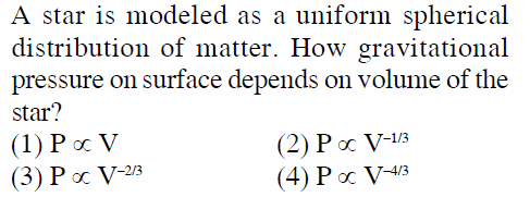

Consider a very thin shell of width dr at a distance r from the center . The volume of this shell is ##4 \pi r^2 ## . Mass is ## m = 4 \pi r^2 \rho## .
P is the pressure at distance r . Gravitational acceleration at distance r < R is ##g' = \frac{GMr}{R^3}##
Doing a force balance on this thin shell .
##P(4 \pi r^2) - (P+dP) (4\pi r^2) = mg'##
## - dP (4\pi r^2) = (4 \pi r^2 \rho)\frac{GMr}{R^3}##
Integrating under proper limits ,
$$ P(r) = \frac{GM\rho}{2R} \left ( 1 - \frac{r^2}{R^2} \right )$$ . V is the volume of the star .
Now , at the surface P(r = R) = 0 .
Is the question wrong ? Should the question be asking about the pressure "at the center" instead of "on the surface" ?Thanks

Derive the equation for the gravitation attraction of a point on the surface in terms of radius and mass and then express radius as a function of volume. And you'll have to get rid of the mass term by expressing it in terms of volume and density (density is a constant you can ignore for the purposes of this problem)
Isn't gravitational pressure 0 at the surface ? Is the problem statement correct ?

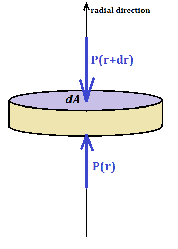

##P(4 \pi r^2)## does not give the total force on a spherical surface. The net force due to pressure on a spherical surface will be zero. The pressure force on a small element of the spherical surface is opposite in direction to the force at a diametrically opposite point.
Instead, consider a small, thin cylinder of height ##dr## oriented as shown below and located a distance ##r## from the center of the star.
I get same result as in OP $$P(r) = \frac{GM\rho}{2R} \left ( 1 - \frac{r^2}{R^2} \right )$$

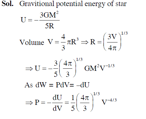

I am attaching the solution provided with this problem . I can't make a head or tail of it o_O. Can you understand how it is being done in the solution ?
No, I don't understand the reasoning there. That dW would be the work required to change the volume by dV at constant pressure P. Why that should relate the pressure at the centre of the star to the total gravitational PE I have no idea.
Other than that, it looks like you have your answer.
I don't understand this solution either. But it does appear that they are finding the pressure at the surface. PdV could represent the work done by the surface pressure on the star for a virtual change in volume dV. Then they equate this to the change in gravitational potential energy ##U## of the star. But off hand, I don't see why you can equate them.
I found some notes here http://star.pst.qub.ac.uk/~sjs/teaching/stellarevol/pdfs/Lecture 3.pdf that might be relevant.
At bottom of page 3 and top of page 4, they develop a relation which they call the "virial theorem": ##3\int_0^{V_s}{PdV} - U = 0##. But note that in deriving this result they assume the pressure is zero at the surface! It is tempting to take the derivative of this expression with respect to ##V_s## to get ##P_s =\frac{1}{3} \frac{dU}{dV_s}##. But that would imply a nonzero pressure at the surface! So, I'm not seeing what's going on here.
