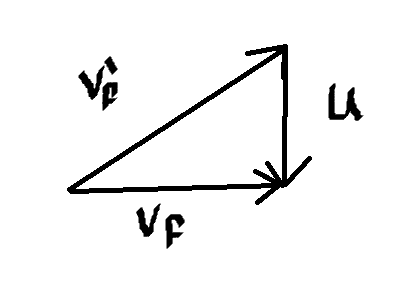

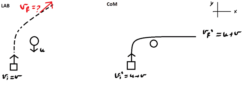

Alright, here's a new attempt at solution using your guidance. Please, take a look at it:
v' denotes in the CoM
v denotes in the lab.
From the CoM frame we have the velocity of the spacecraft as v'_i=u+v (VECTORS)
The energy of the spacecraft in the rest frame is conserved therefore at infinity it will have the same velocity but in a different direction. Hence, the magnitude |v'|=|v'_f|=u+v.
Since the spacecraft couldn't have simply gained momentum in a different direction and is affected by the planet, I assumed the v'_f=(u+v) to be at some direction w.
Going back to the lab frame of reference by adding up u, we know that the velocity v_f is in the x direction. therefore v_f=v'_f+u
Using the Pythagorean theorem I get that v_f=sqrt[(v^2)+(2uv)].
I'll add up a sketch in a second of the vectors.
If I'm wrong anywhere, please, it would help if you could denote where , why and how I could get it right because I must hand this in tomorrow.
Thank you!
Also anyone else is welcome to check out my attempt.
CORRECTION:
Apparently (according to the teacher in our class) the eccentricity is given in the planet's rest frame. Hence, it does the hyperbolic trajectory there and not relative to "space". Which makes my answer wrong. I'll correct it and update in a second.
This, I believe, is the right sketch:
Again, the same explanation as above for the velocities and all.
I believe that the final velocity v_f is now (as a vector) : v_f=(u+v,-u)
Therefore its magnitude is |v_f|=sqrt[(2u^2)+(v^2)+(2uv)] .
What do you think Orodruin?
Edit: Ah, it moves in x-direction as seen by the planet? Then the new answer is correct.
Well, it's hyperbolic from both perspectives, just different eccentricities.
Your diagram at post #14 is now wrong/misleading. In the left hand picture, the trajectory should wrap around the back of the planet and head down and to the right.
