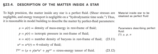

Here is a "recipe" from MTW's Gravitation:
Likes PeterDonis, PeroK and Ibix
Is ##n## (23.28c and d) defined somewhere? Number density of particles?
Here:
Likes PeterDonis and Ibix
