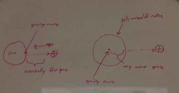

Wait, the gravity from the sun taking 500 seconds is not like the gravity coming from a black hole. The lag is purely because of distance and the speed at which gravity works, but from the mass of the sun, to the earth, that gravity is traveling through essentially flat space (compared to a black hole anyway.) Look at my diagram (sorry about my handwriting.)
On the left is the sun, which is the gravity source. The "graviton" would travel from the gravity source, through space, to the earth. It's affects would then be felt.
On the right, you have a black hole. You have the gravity source in the middle of the black hole and a planet orbiting it. You have the flat(ish) space between the event horizon and the planet, but there is a gap. How does the gravity come from the gravity source all the way in the center of the black hole, through all that space that's curved so much that all geodesics point inwards?
In both diagrams, the "path" of gravity is the dotted line. How does gravity get through the part I've labeled as "very curved space?" What is the path from the gravity source in the center of the hole, to the edge of the Schwarzschild radius?
Is it because from our point of view, as objects approach the event horizon, they stop in time? Is the gravity source felt by orbiting objects from the surface of the black hole and not the singularity inside?
And the same is true in the black hole case; the gravity you feel hovering above the hole comes from the stress-energy in your past light cone, i.e., from the matter that collapsed to form the hole. The only difference is that the matter might have collapsed millions or billions of years ago--but because of gravitational time dilation, light signals from the collapsing matter just before it fell below the horizon can take that long to get out to you. The same is true of "gravity signals" if you assume that gravity propagates at the speed of light (which is what GR predicts although we have not directly measured this).
No, you don't. Your assumptions about the geometry of spacetime in the interior of a black hole are not correct. The black hole is vacuum inside. The singularity at the center, ##r = 0##, is not, strictly speaking, part of spacetime at all; but considered as a boundary of spacetime, it is in the future--i.e., it is a moment in time (which is in the future of anyone inside the horizon), not a place in space.
It doesn't. Once again: the gravity is not coming from inside the hole. It is coming from the matter that collapsed in the far past to form the hole. Please take a big step back and think very carefully about what that means.
There is a sense in which this is sort of getting at a piece of the answer (see my comment above about how long light takes to get out to you from close to the horizon), but it has nothing to do with objects "stopping in time", it has to do with the propagation of light (or gravity) near the horizon.
Neither. I've already said where the gravity comes from. Please read what I posted again, carefully.
Likes Imager and newjerseyrunner
