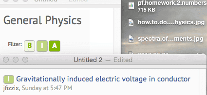

Drakkith said:
Don't look at me. This is a bit beyond my skill level.
You were supposed to say; "The "I" in this case does not mean "intermediate". It means "infinitely over Om's head", and you have my permission to "Unwatch" this thread. We will not think less of you. Now go do some gardening, old man".
ps. I did do some more calculations, and discovered that a one atom wide wire of copper, one meter long, has a theoretical resistance of 326 billion ohms, and the resistance between two adjacent atoms is 92 ohms. I thought that was interesting. Not sure if it means anything.
