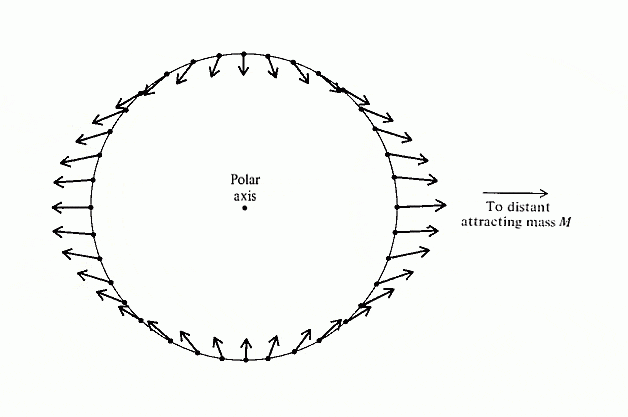

Let's get down to Earth and look at the tides. I'll designate the positions with respect to the center of the Earth of the Moon as [tex]\vec r_m[/tex] and that of a drop of water on the surface of the Earth as [tex]\vec r_d[/tex]. From the perspective of an inertial frame, the gravitational force on this drop of water by the Moon is
[tex]\vec F_{\text{inertial}} =
- \frac{Gm_mm_d}{||\vec r_m - \vec r_d||^3}(\vec r_m - \vec r_d)[/tex]
The Earth is accelerating toward the Moon as well as the droplet. To obtain the net force on the droplet from the perspective of an Earth-centered frame we need to subtract the fictitious force resulting from the Earth's acceleration toward the Moon:
[tex]\aligned
\vec F_{\text{Earth-centered}} &=
- \left(-\,\frac{Gm_m}{||\vec r_m||^3}\vec r_m\right)m_d
\\[6pt]
- Gm_m
\left(
\frac{\vec r_m - \vec r_d}{||\vec r_m - \vec r_d||^3}
- \frac{\vec r_m}{||\vec r_m||^3}
\right)m_d
\endaligned[/tex]
Here is a graphical depiction of these tidal forces:
