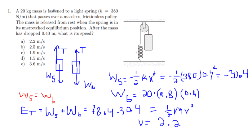

Gravity and Spring + KE problem

KE = .5mv^2
KE = Total Work
Total work = Work by block - work by spring
Shown above.
Did i do the problem correctly? I'm always unsure if I am doing the problem right

Yes this is right but you made this free body diagram comparing force with work done
Good point.
