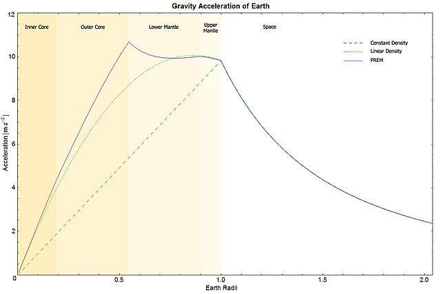

deadcat said:
Why would he fall faster when he gets to the outer core?
He would accelerate the most at boundary of the outer core, because the Earth is not of uniform density:

This is one and the same reason, expressed in two different ways. But it doesn't take non-uniform density into account.
