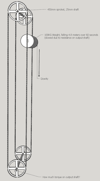

Im prototyping a machine to lower liquid from a height using a chains and sprockets. Essentially liquid will fill at top, be lowered over a distance of 4.8 metres then emptied at bottom. The liquid needs to be lowered at a slow pace due to resistance on the output shaft, I am considering utlising an alternator to provide resistance and convert rotational torque into electricty. I need to work out the forces involved and need some help with the math!
I have put together a basic model with the variables/inputs and would like some help figuring out the following:
Whats the relationship between weight, gravity, speed, losses and output shaft torque?
To achieve 70NM torque on output shaft, how much weight is needed?
What are the calculations for this problem?
Let me know if questions and more info needed, and thanks for any help in advance!
Assuming a 1 metre radius.
Force required = 70 N;
Gravitational acceleration, g = 9.8 m/s²
Force = mass * acceleration; F = m * g;
∴ m = F / g = 70 / 9.8 = 7.14 kg.
The first two are easy.
Weight (kg force): gravity x mass.
Gravity: 9.81 m/s^2
The last two are not so easy. Well, the last one is easy if you're not doing any kind of gearing. The torque on the sprockets in your setup is simply force x distance, where distance is the distance from the center of the shaft to where the ropes/belts are attached to your weight. That is, ##\tau = rFsin(\theta)##, where ##r## is the distance I just mentioned, ##F## is the force, and ##sin(\theta)## is the angle between the force vector and the lever arm. Note that this changes if you introduce any kind of non 1:1 gearing or levers.
As for losses, that depends mostly upon the details of what you're attaching the output to. You'll lose some amount to friction even with no output load, and anything you attach to the output, such as an alternator, will have some amount of losses. But that's impossible to know ahead of time. You'd have to directly test whatever you're using.
Knowing the speed is much more difficult, as you have to consider the rotational inertia (moment of inertia) of every rotating object in the system, the inertia of every linearly moving object in the system, and how your output load behaves.

Thanks for this.
I actually provided the wrong details of the output force required which should be 5100NM (not 70!)
So using your calculation I get the following:
m = 5100/9.8 = 520kgSo the 1 metre radius would be my sprocket? How is the sprocket radius accommodated in the calculation?
Also the fact that I want the lowing of the mass to be slowed down (IE not freefall) how would this effect the math?

Thanks for the advice and math for calculating the torque on sprocket. Im a little rusty on trig and not sure how to calculate theta, do you mind showing me the calculation based on my varriables?
We could assume 500kg weight
Distance from centre 225mm
Speed sounds complicated. Is there a general rule which would help estimate the force implications if the failing speed was lowered? IE ignoring subtle variables and resistance, would slowing the rate of lowering from gravitational acceleration (such as 50%) be equivalent to reducing gravity from 9.81m/s to 4.4m/s? Ideally Id like to lower the weight at around 0.1m/s!
You don't calculate theta, it's built into whatever your design is. In this case, with a chain on a sprocket, theta is always 90 degrees (or pi/2 if you're working in radians). Since sin(90)=1, the torque equation simplifies to: ##\tau = rF##

Thanks @Drakkith, I appreciate your time and input. That all makes a lot of sense.
An important part of this exercise is me learning the math involved so it has not been pointless or a waste of time! Thanks to you I have a much clearer understanding of the forces involved for several of my ideas :)
My water source flows at 30 litres per second, so not huge. I figure 100 litre containers would be too big as would take over 3 seconds to fill. So perhaps 30L containers are better suited for my water source, taking 1 sec to fill. In 4.8m spacing would allow approx 20 containers of 30L decending so total volume = containers x volume, v=20 x 30 = 600 litres/kg.
600kg energy potential over 4.8m we get u=600x9.81*4.8 = 28,252.8 J
600kg lowing at 0.3m/s over 4.8m we get p={28252.8}{16} = 1,765.75 Watts
Im not exactly sure how now to convert watts into rotational torque on output shaft in Nm, but I can already deduce that if I wanted to generate electricity based on this concept, it will be 1765.75 Watts less losses. There is obviously a lot of engineering and challenges involved such as getting the water into the containers effectively while moving and fabricating such a large machine. Ill think about it some more ;)
Water flow rate = 30 litres per second (=30 kg); 4.8 metre drop; g = 9.8 m/s².
Potential energy, E = m·g·h = 30 * 9.8 * 4.8 = 1411.2 joule/sec = 1.4 kW.
Power (watts) = Torque (Nm) * angular velocity (rad/s),
Angular velocity (rad/s) = RPM * 60 * 2π .
