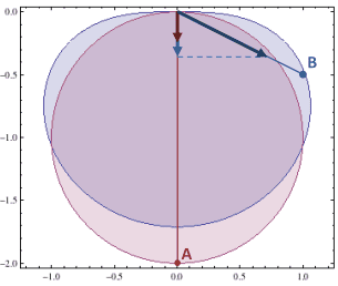

Here is another counter example to the above:
http://pages.physics.cornell.edu/~aalemi/random/planet.pdf
In Figure 3, the flattened blue planet has stronger surface gravity at the top than the red sphere of equal mass and density, despite having less mass "between the poles and the center" than the sphere.

Very interesting though I find it hard to get my head around the fact that the flattened blue planet attracts matter with more force horizontally .
I was always taught that gravity works in the vertical plane more strongly and has little or no effect horizontally.

You have to consider both: the direction, and the magnitude (which depends on distance).

Here is Fig 3 from http://pages.physics.cornell.edu/~aalemi/random/planet.pdf with some force vectors added :
Point A is ~1.79 times further away from the top than point B, making B's direct attraction 3.2 times stronger. So despite B pulling mosty sidewards, it still creates ~1.43 times more downwards pull than A. Therefore by moving mass from A to B, you increase the surface gravity at the top.
