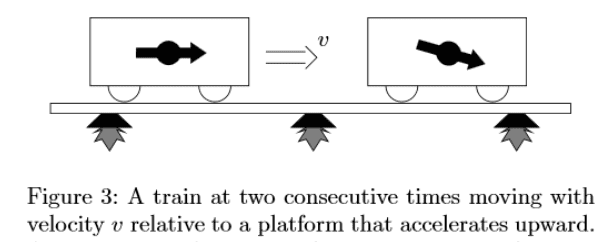

Let's have a train moving at relativistic speed on a flat planet (so that the train goes straight). Also the gravity is supposed to be constant, say [itex]g[/itex].
The passengers set up an experiment, in which light is sent from the center of a train car horizontally forward and backward and they measure the height where it hits the walls.
There is a view which I call "stationary preferred", in which the light will be seen to fall with acceleration [itex]g[/itex] by a stationary observer. So the light will hit the back wall at nearly the original height, but it will hit the front wall a good bit lower - since it takes much more time to reach the front wall.
Another view is "passenger preferred", in which the light hits the walls nearly at the original height, same on back and front wall. It seems both views cannot be correct, and the "passenger preferred" is incorrect.

No, it works like this: I stand still and watch a transparent accelerating rocket, inside of which the experiment of sending light beams to the walls is conducted. The light beams hit the walls at the same altitude. Now I start to accelerate orthogonally to the rocket acceleration. This causes the rocket wall that is farthest away from me to gain lead compared to other walls, in my frame. Light beams still hit the same spots on the walls.
(The synchronized motion of walls in one frame is a non-synchronized motion of walls in another frame)
Now the case with gravity: A transparent train and I are standing on the surface of a planet and inside the train the experiment of sending light beams to the walls is conducted. The light beams hit the walls at the same altitude. Now I start to accelerate orthogonally to the gravitational acceleration. This does not cause the train wall that is farthest away from me to gain lead compared to other walls, in my frame. Light beams do not hit the same spots on the walls.

Well is there not enough accelerating and moving happening? And still the light hits the same spots of the walls. Some acceleration may be there because it is very easy to see what effect motion has when there is first motionlessness.
Or could a train moving inside an accelerating rocket be a different thing than a rocket that is accelerating and moving sideways? Hmm.. Oh dear, yes it is, because the rocket floor keeps the train aligned with the floor.
So, when the train is accelerating along the floor it feels the floor tilting. When the train moves along the floor, does it have to use energy to keep the velocity constant on the tilted floor? Hmm ... No because if the floor is tilted then the rocket nozzles are equally tilted and 'gravity' is perpendicular to the floor. When the train accelerates, the whole rocket turns according to the train, that's how it is, probably.

Since nobody has taken up my suggestion in post #2, I'll do it myself. This is a scenario where, as we will see, it's important to actually do the math, instead of making heuristic guesses, because what happens is somewhat counterintuitive.
So we have a "rocket" which is accelerating in some specific direction, which we'll call the ##x## direction, with proper acceleration ##g## (more precisely, this is the proper acceleration of an observer at rest at the bottom of the rocket, but we can consider the rocket's height to be small enough that ##g## is constant everywhere inside it). This rocket is very wide in one of the transverse directions, which we'll call the ##y## direction, and we have a train moving inside the rocket in that direction (the ##y## direction) with speed ##v## as measured by an observer at rest in the rocket, and rest length ##L##. At some instant, a pair of light beams is emitted by a source moving with the train, in the ##+y## and ##-y## directions. The question is, what is the motion of these beams?
Let's first look at things in an inertial frame in which the rocket is momentarily at rest at the instant the light beams are emitted; this instant will be ##T = 0## (we will use capital letters for coordinates in this frame to avoid confusion). In this frame, we can assign coordinates as follows: the bottom of the rocket is at ##X = 1 / g## at ##T = 0##; the light source is at ##X = 1 / g + \delta## at ##T = 0##; and the beams are emitted in the ##\pm Y## direction. The train's speed is ##v## in this frame (since the rocket is momentarily at rest in the frame), and the length of the train in this frame is ##L / \gamma = L \sqrt{1 - v^2}##. In this frame, the backward-moving light beam will take time ##L \sqrt{(1 - v)/(1 + v)}## to hit the back end of the train, and the forward-moving light beam will take time ##L \sqrt{(1 + v)/(1 - v)}## to hit the front end of the train. The bottom of the rocket moves a distance ##\frac{1}{2} g T^2## in time ##T##, provided ##T## is small enough (we are assuming it is, i.e., that the height ##\delta## of the light source and the rest length ##L## of the train are small enough), so the distances moved will be ##\frac{1}{2} g L (1 - v)/(1 + v)## and ##\frac{1}{2} g L (1 + v)/(1 - v)##, and the height above the bottom of the rocket at which the two light beams strike will therefore be ##\delta## minus these two distances. Obviously this final height will be smaller for the forward-moving beam than for the backward-moving beam.
Translating the above into Rindler coordinates, which correspond to the "stationary" frame, is simply a matter of reinterpreting the heights ##\delta - \frac{1}{2} g L (1 - v)/(1 + v)## and ##\delta - \frac{1}{2} g L (1 + v)/(1 - v)## as the ##x## coordinates (lower case ##x## since we are now talking about Rindler coordinates) of the light beams at the instant they strike the back and front ends of the train, respectively. That is, instead of the bottom of the rocket accelerating in the ##+ X## direction at ##g##, we now have the light beams accelerating in the ##- x## direction at ##g##. Everything else is the same, since we have ##t = T## to a good enough approximation for the duration of the light beams' travel.
The question now is, how do we translate all this into the rest frame of the train? Let's first try to translate into an inertial frame moving at ##v## in the ##Y## direction relative to the inertial frame we used above. The events of interest have the following coordinates in the original inertial frame:
Light beams emitted: ##T = 0##, ##X = \delta##, ##Y = 0##. Bottom of rocket at this instant (directly below light source): ##T = 0##, ##X = 0##, ##Y = 0##. (This event is the common origin of both frames.)
Back light beam hits back of train: ##T = L \sqrt{(1 - v)/(1 + v)}##, ##X = \delta##, ##Y = - L \sqrt{(1 - v)/(1 + v)}##. Bottom of rocket at this instant (directly below back of train): ##T = L \sqrt{(1 - v)/(1 + v)}##, ##X = \frac{1}{2} g L (1 - v)/(1 + v)##, ##Y = - L \sqrt{(1 - v)/(1 + v)}##.
Front light beam hits front of train: ##T = L \sqrt{(1 + v)/(1 - v)}##, ##X = \delta##, ##Y = L \sqrt{(1 + v)/(1 - v)}##. Bottom of rocket at this instant (directly below front of train): ##T = L \sqrt{(1 + v)/(1 - v)}##, ##X = \frac{1}{2} g L (1 + v)/(1 - v)##, ##Y = L \sqrt{(1 + v)/(1 - v)}##.
We now simply do a Lorentz transformation at speed ##v## in the ##Y## direction, to obtain:
Light beams emitted: ##T' = 0##, ##X' = \delta##, ##Y' = 0##. Bottom of rocket at this instant (directly below light source): ##T' = 0##, ##X' = 0##, ##Y' = 0##. (This event is the common origin of both frames.)
Back light beam hits back of train: ##T' = L##, ##X' = \delta##, ##Y' = - L##. Bottom of rocket at this instant (directly below back of train): ##T' = L##, ##X' = \frac{1}{2} g L (1 - v)/(1 + v)##, ##Y' = - L##.
Front light beam hits front of train: ##T' = L##, ##X' = \delta##, ##Y' = L##. Bottom of rocket at this instant (directly below front of train): ##T' = L##, ##X' = \frac{1}{2} g L (1 + v)/(1 - v)##, ##Y' = L##.
Notice that the ##X'## coordinates are the same in this frame as the ##X## coordinates were in the original inertial frame, so the height differences are unchanged; the backward-moving beam still hits higher above the bottom of the rocket than the forward-moving beam. And this is true even though, in this frame, both beams hit at the same time! How is this possible?

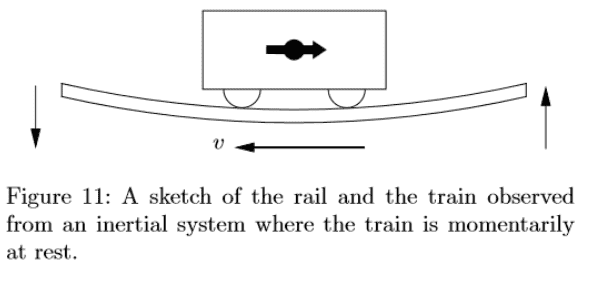

To see what we missed, let's look at the events describing the points on the bottom of the rocket that will be directly below the back and front of the train when the light beams hit those ends of the train, at the instant the light is emitted. In the original inertial frame, these events are:
Bottom of rocket below back of train: ##T = 0##, ##X = 0##, ##Y = - L \sqrt{(1 - v)/(1 + v)}##.
Bottom of rocket below front of train: ##T = 0##, ##X = 0##, ##Y = L \sqrt{(1 + v)/(1 - v)}##.
Now we transform these events into the new inertial frame, moving at ##v## in the ##Y## direction:
Bottom of rocket below back of train: ##T' = v L / (1 + v)##, ##X' = 0##, ##Y' = - L / (1 + v)##.
Bottom of rocket below front of train: ##T' = - v L / (1 - v)##, ##X' = 0##, ##Y' = L / (1 - v)##.
Now we see what is happening: in the train frame, the rocket is "tilted" in the ##Y'## direction--the rocket below the back end of the train is at ##X' = 0## at a later time than the rocket below the front end of the train. So when the light beams hit the ends of the train (which happens at both ends at ##T' = L## in this frame), the bottom of the rocket at the back end is at a lower ##X'## coordinate, and hence the beam hits at a higher height above the bottom of the rocket.
Translating this into the actual rest frame of the train should again be simple: we just reinterpret acceleration of the rocket in the ##+ X## direction as acceleration of the light beams in the ##- x## direction. Everything else stays the same, including the above conclusion that the backward-moving beam hits at a higher height above the bottom of the rocket.

The math (and effort :wideeyed:) is impressive indeed, and seems to be correct. However, I'm still having trouble interpreting it, and can't quite agree with your conclusion.
First, it's clear that there is some kind of tilt or rotation even before the last part, in the part I quoted. The last paragraph, transforming simultaneous events in one frame into another frame, is meaningless.
Anyway, I can't accept the resolution that the train is running uphill, and that's why light hits the front wall lower. The passengers are sending light parallel to the floor, even if the train was rotated or even tilted.
Further, let's consider a ball on a horizontal table in the train. We'll view it from the only reasonable frame (the one you started with), where the train is moving, and the rocket accelerating. The ball or table is never accelerated in any direction other than +X, so there's no reason it would ever fall from the table. So the gravity points "down", even if things may fall in funny ways.
Same reasoning applies to the question whether the train would slow down. Sometimes I think it should, but the argument with a ball on table looks correct.

Huh? That's impossible; the floor is accelerating upward. More precisely: the floor is accelerating upward in the ##X## direction, and the light is moving in the ##Y## direction, in the original inertial frame (the one in which the rocket is momentarily at rest at ##T = 0##). That means that, at an instant of time in that inertial frame, both light beams are the same distance from the floor of the rocket. (This may be what you were trying to say by saying "parallel to the floor", but it's very important to be precise, as you'll see in a moment.)
Now: since the train is moving in the ##Y## direction in the original inertial frame, then when we transform to an inertial frame in which the train is at rest (more precisely, it's momentarily at rest at ##T' = 0##--it is accelerating in the ##X'## direction, but we're assuming the acceleration is small enough that we can approximate things using the inertial "train frame"), we will find that it is impossible, in the new frame, for the light beams to be the same distance from the floor of the rocket (except at the instant ##T' = 0## when the beams are emitted). This is an obvious consequence of relativity of simultaneity: events which are spatially separated cannot be simultaneous in two different frames. Since we know by hypothesis that events at which the two light beams are at the same distance from the floor of the rocket are simultaneous in the original inertial frame, such events cannot be simultaneous in the new inertial frame (the "train frame"). That is the missing piece we need to understand why the backward-moving light beam hits higher in the train frame.
Yes, that's correct. But it's irrelevant to my argument. I am not saying that gravity in the train frame points in a different direction. In fact, if you look at my calculations, I am making use of the fact that the acceleration in the train frame is in the ##X'## direction only.
Once again, the key point has to do with relativity of simultaneity; that's where the counterintuitive feature comes in. There is nothing counterintuitive about the direction of gravity in this scenario; if you are focusing on that, you are missing the point.

A couple of questions. Would a marble placed on the floor of the train roll towards the back? Would a string attached to a penduluum-like mass hung from the ceiling of the train make an acute angle facing the rear wall, and an obtuse angle facing the front wall, rather than hang straight down?
PeterDonis's analysis seems to suggest the answers to these would be yes, but I may be misinterpreting.
Thanks!
... and another question:
Wouldn't it actually require a y-directed force just to keep this train moving at v in the y-direction?
I ask because if the accelerating rocket's floor were the only force acting on the train, then in order for the train to conserve its momentum in the y-direction as it is accelerated in the x-direction, its velocity in the y direction would decrease, no? So holding the train's y-velocity constant would mean an increase to its y-momentum, which would in turn require a constant infusion of energy, hence a y-directed force on the train, right?
Guess I'm falling for same trap PeterDonis has criticized throughout this thread: I didn't do the analysis or math. I'm just extrapolating this from another staff mentor's answer to my question in the thread I started, "need some help understanding electromagnetics and relativity". The scenario in my question is a little analogous to this one. The field E plays the part of the rocket and the charged particle plays the part of the train.

Here's my analysis:
The floor and the marbles on the floor recide approximately at the same point in space. If some forces are affecting the marbles, then the same forces are affecting the floor. Floor and marbles move in sync.
On the other hand the floor and the ceiling are forced to move in sync by the walls, except that the walls are Lorentz contracting, so the floor and the ceiling are not co-moving, if observed by an inertial observer. Therefore the ceiling is pulling the floor forwards making the marbles on the floor to roll backwards. The strength of this effect depends on the floor-ceiling mass ratio and floor-ceiling distance.
EDIT: As seen from an inertial frame, the longitudinal motion of the floor slows down as the transverse motion of the floor speeds up. Longitudinal means along the floor's long axis. This is closely related to time dilation.EDIT2: It may be important that as the walls are Lorentz contracting and the floor is moving towards the ceiling, horizontal laser beams shot by one laser gun on the floor and other laser gun on the ceiling will cross each other. This is the effect known as aberration, or relativistic beaming.
No. "Gravity" still points straight down inside the train.
No. Once again, look at things in an inertial frame in which the rocket is instantaneously at rest. The train is moving at ##v## in the ##Y## direction in this frame. It gets accelerated in the ##X## direction, but that doesn't affect its motion in the ##Y## direction at all.
Why do you think that would be the case? The acceleration of the rocket only affects the train's momentum in the ##X## direction, not the ##Y## direction.
Why do you think this is the case?

  • #32
The floor and the ceiling are not co-moving in an inertial observers frame because in the inertial observers frame there is this kind of momentary situation: The ceiling moves at speed 10 m/s relative to the observer. The floor moves at speed 10.1 m/s relative to the observer.
(Because walls are Lorentz contracting at rate 0.1 m/s at that moment)
  • #33
Lorentz contracting in which direction? Do you mean the ##X## direction, because of the acceleration of the rocket? How are you deriving the "rate of Lorentz contraction"? And what does this have to do with motion in the ##Y## direction?
  • #34
Yes, I mean the ##X## direction, because of the acceleration of the rocket.
Let's say our train inside the rocket moves back and forth. It's a clock now. Clock's ticking must slow down as speed of clock increases. Ticking is back and forth motion in this case. Now let's put many identical train-clocks at different X-coordinates. The trains-clocks must go out of sync just like any other clocks at different altitudes would do.
I don't want to derive the "rate of Lorentz contraction" right now ... But if a rocket has proper acceleration a1 and a rock towed by that rocket has proper acceleration a2 then there is a "proper contraction acceleration" of a2 - a1 I mean the end of the towing rope accelerates with proper acceleration a2 - a1 towards the other end of the rope because of the contraction of the rope.
Previous paragraph may be safely ignored : ) Actually "rate of Lorentz contraction" is the difference of lengths at different moments, divided by time between the moments, and measured by an observer that is not accelerating. Well that's just a definition, not a derivation.
