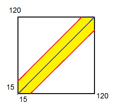

Usual solution is with Geometric Probability: The arrival times of Kathy and Dave are represented by the (x,y) points of the square. Dave and Kathy meet if their times of arrival are in the yellow strip.
The probability is the ratio of the area of the yellow strip to that of the total square.
