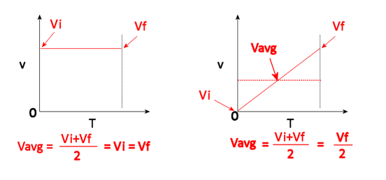

Just to add to what Vanadium 50 has already said.
Consider the two graphs below. Both are for velocity over time. The one of the left is for an object at constant velocity and the the one of the right for an object starting at 0 velocity and under a constant acceleration.
In both cases, distance traveled during the interval is the average velocity for the interval multiplied by the time of the interval.
in the constant velocity case, Vi=Vf so the average velocity is equal to both initial and final V. In the accelerating case, Vi=0, so the average velocity for the interval = Vf/2 and since Vf= at, we get at/2 x t = at2/2 for the distance traveled.
You may have also notice that in the left image that the formula Vft also give you the area under the red velocity line.
If I shade the area under the velocity line for the right image, I get this
Notice that the little red triangle above the Vavg line would fit perfectly into the empty area under the Vavg line, meaning that the shaded area is equal to (Vf/2)t meaning the area under the velocity line also equals the distance traveled in the case when you have acceleration.
