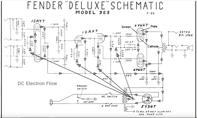

In summary: Center Tap in the power transformer secondary. This symbol indicates that the Center Tap is the "source" of all the DC electrons that the amp will need. (See the gray lines with arrows in the second attachment.)

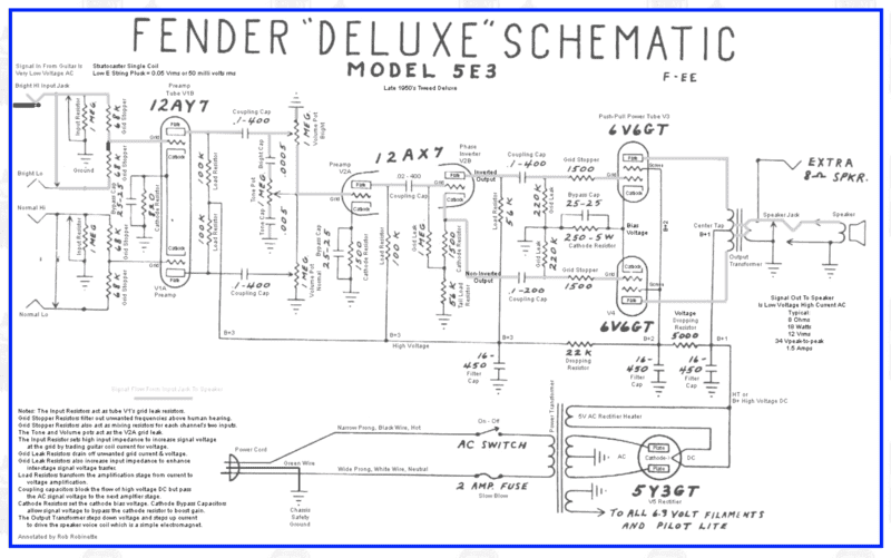

Thanks for your quick reply. I have attached three examples, one in particular showing the flow of electrons and the all of it flowing from the Center Tapped secondary of the power transformer...the schematic will the gray lines with arrows (second attachment).

Thinking about electrons flowing is not a very good way to understand electronics, but to work out the answer to your question look in the middle picture at the ground symbol at the head of all the arrows to the other ground symbols. There is a wire connected to this ground symbol from the centre tap of the transformer with an arrowhead pointing towards ground. Keep following the arrowheads back "upstream" and you will see where they come from
The total number of electrons inside the amplifier must remain constant otherwise it would build up charge until it explodes in a flash of lightning!
Each of those schematics shows the secondary center tap connected to the "ground" that the mains power supplies. Although the 2nd one is complicated. That "ground switch" implies some sort of dumb-a## common mode filter, I guess. But the point is it wouldn't be there if that wasn't intended to be associate with the mains ground.
EE's will often refer to "ground" as a common reference point which may not be related much to the dirt you stand on. For example, in a car which sits on rubber wheels. It is often a chassis, or maybe a Cu spike pounded into the ground, sometimes a big sheet of Cu inside a PCB, but the functional currents that make the circuit work won't actually flow away to those locations. Excluding subtleties, those circuits would work just as well if all of those ground symbols were removed and replaced with wires.
I did many designs with schematic symbols for "Analog Ground", "Digital Ground", and "Chassis/Earth Ground". It was just a way of conveying to readers the separation of current flow paths into separate regions. In the real world they were just wires or traces/planes on a PCB.
So, maybe I don't understand your real question, or you are putting more meaning into "ground" than is necessary to understand the basic function of the circuit. There are some practical but esoteric reasons that EEs include the mains ground in their designs (primarily EMC and safety issues), but I think that is beyond the scope of your question.
For an amplifier, just think of "ground" as a frequently used connection that things are referenced to. It's primarily a convenience for the designer and the people reading the schematic to refer to the most common, most significant, or a special net in the circuit.
The second schematic has the well known 'death switch' that weakly couples the chassis of the amp to hot or neutral to help combat hum. It's a controversial thing. Some people swear the only thing preventing the death of a guitar player is they just never happen to be touching anything else to complete the circuit. In reality if the 600 volt capacitor doesn't fail shorted little will happen. Nonetheless, not a wise move.
