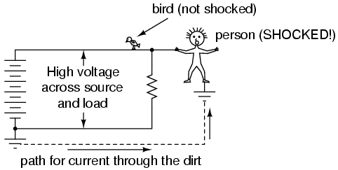

The person who touches the cable while standing on the ground will be electrocuted IF by touching the wire, he forms a complete circuit from the cable via his body, through the ground and back to the voltage source.
It is common for one side of a power system to be electrically connected to the earth, or at voltage reference point 0 V. So if someone touches the grounded side of the cable, nothing will happen. But if he touches the non-grounded side, then he completes a circuit between the higher voltage cable back to the original source through the dirt in the earth.
This is of course a high impedance (resistance) path for the electricity, but think of V = IR (or the current I = V/R, meaning that even though R is large, V for a typical power cable is very, very high). Most of the electricity will travel along the original path back to the EMF source, but enough will go through the human's body and the ground to cause electrocution.

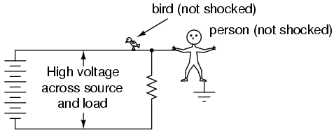

On the other hand, if one side of the cable is not grounded, he will not be electrocuted by touching the higher voltage cable, since there is no complete circuit through the ground back to the voltage source.
These diagrams illustrate what I mean (and are taken from the following website, with which I am unaffiliated - I suggest you read this for a better understanding)
http://www.allaboutcircuits.com/textbook/direct-current/chpt-3/shock-current-path/
Diagram 1: Person gets electrocuted if one side of the power system is grounded.
Diagram 2: If neither side is grounded, then nothing happens.

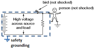

Thanks a los for the info! It really cleared most of my questions. However, we are talking about ALternate current which makes electrons go back and forth. It may sound silly but how can we know were the lowest electric potential is when the current is not actually going in a single direction?
The bird does not get electrocuted because there is no difference of voltage between its "terminals"? I don't really get it. It sounds more like a parallel connection to me were current prefers circulating through the path of less resistance rather than the birds body. Am I wrong?
This is a bit out of the topic but I remember a teacher told me that thunders induce high voltages in cables. Does Earth play some kind of safety role in here? Most devices have the live, neutral and ground terminal in their sources. What's exactly the role of the ground connection in this case?
Yes, the bird's feet, legs, and body are making a parallel connection across a tiny section of the wire, but the resistance is very high compared to that through that same section of wire. Yes, there will be a current flow through the bird, but VERY small. This current will increase as the voltage in the wire circuit increases.

You cannot touch a live conductor -even in an ungrounded system.The natural grounding impedance of the system-capacitance between conductor and ground or insulation resistance-it is still enough to facilitate return the current to the source.
If the enclosure would be grounded, even in a case of a fault a live conductor touch the enclosure, then the potential of enclosure decrease up to close to ground potential and the person would get only this very low voltage between his touching organ and ground -or a grounded object.
The "potential" it is the voltage difference between two points: one considered "0" or reference.Usually the remote "infinite" point is considered "0"- sometime the "clear ground".
