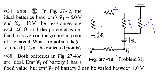

I attatched my question as a picture
1.i found a solution using kirchhoff law, V1=-11V,V2=-9V
and it was correct. but i`m not sure that my method was right.
i know that kirchhoff law is originated from charge and energy conservation but in the problem there is a circuit which is grounded, so i think that charge can in and out through it. consequently, charge doesn`t have to conserve in circuit.
can i use kirchhoff law in this problem? and why?2.i found that current go to ground is 0 using kirchhoff law. but i don`t know why it is

If you see the ground and electrical circuit is an isolation system. V at ground =0. On the other hand, the ground doesn't create works.
