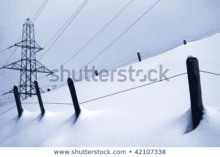

snow depth
Good point! I never thought of that, but I can see how that would be a big factor for the transmission line paths through the Sierras and other places that get a significant snow pack.
https://image.shutterstock.com/image-photo/image-450w-42107338.jpg

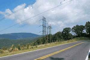

@berkeman , this crossing always stands out in my mind. It seems shockingly low. It is Skyline Drive in Shenandoah National Park, a mountain ridge. The mountain slope is 30-45 degrees. In the foreground is a 115 KV line and behind is a 230 KV line. Vehicles up to 12 feet tall drive on that highway. Maybe snow blowers too.

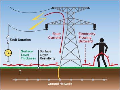

Might be a good time to mention Step-Potential.
image compliments of
https://www.esgroundingsolutions.com
