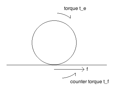

Suppose a wheel with radius [itex]R[/itex] is resting on a non-inclined surface. A torque [itex]\tau[/itex] is applied to the wheel center. In an attempt to prevent wheel from spinning, the ground applies a static friction force to the wheel at the contact point (parallel to the surface), then the wheel starts rolling without spinning. The same friction force also acts as a torque on the wheel around its axis.
This scenario is depicted below:
I'm trying to find the magnitude of the force the ground applies to the wheel - that is, the force which drives the wheel forward (which should be the same in magnitude as the force the wheel applies to the ground at the contact point). And also the magnitude of the counter torque the ground is applying to the wheel (in counter clockwise direction). And also the final angular acceleration of the wheel

Substituting [itex]\alpha[/itex] and [itex]a[/itex] in [itex](1)[/itex] gives:
[itex]\frac{f}{m} = \frac{\tau_e - f \centerdot R}{\frac{1}{2}mR^2}R[/itex]
Rearranging:
[itex]f = \frac{2}{3}\frac{\tau_e}{R}[/itex]
And that is the force [itex]f[/itex] from static friction which pulls the wheel forwards without making it spin or slip, and consequently, the force the wheel applies to the road surface at the contact point.

hi ri_r! welcome to pf! :smile:
ri_ri said:
… [itex]f = \frac{2}{3}\frac{\tau_e}{R}[/itex]
But I found this link:
http://www.asawicki.info/Mirror/Car Physics for Games/Car Physics for Games.html
And it says:
"The torque on the rear axle can be converted to a force of the wheel on the road surface by dividing by the wheel radius. (Force is torque divided by distance)."
That statement doesn't match the approach I used above …
your approach is correct
the quote is wrong, for the reason you give
as to the other parts of that link, the writer admits …
"I've found somewhere that the inertia of a solid cylinder around its axis can be calculated as follows:
inertia of a cylinder = Mass * radius2 / 2"​
… so he can't remember where he found it, and he doesn't know how to work it out! :rolleyes:
… and so i suggest you ignore the link completely
btw, you can also do τ = Iα about the moving centre of rotation (because it – the point of contact – is moving in a straight line parallel to the centre of mass), which immediately gives you α = 2τe/3mr2 :wink:
