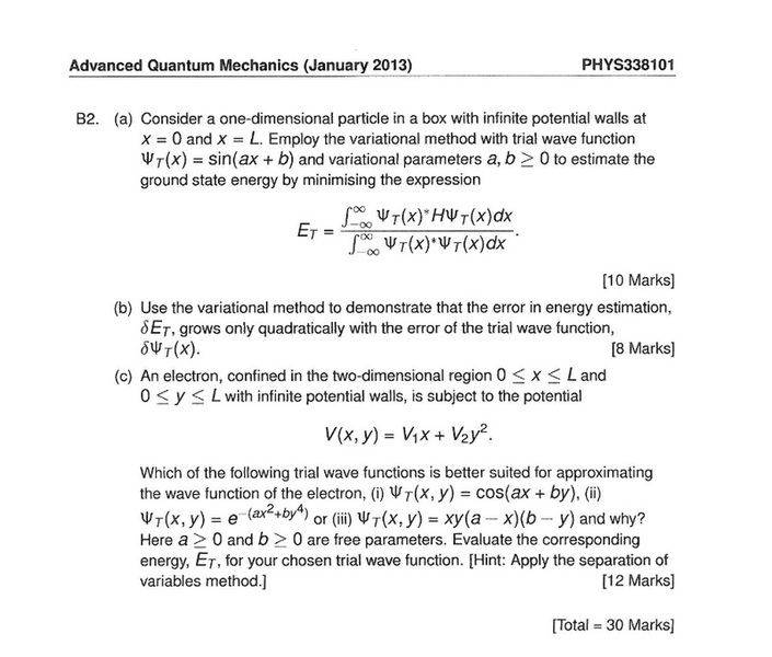

Consider a one-dimentional particle in a box with infinite potential walls at x=0 and x=L. Employ the variational method with the trial wave function ΨT(x) = sin(ax+b) and variational parameters a,b>0 to estimate the ground state energy by minimising the expression

It's from a past exam paper I'm working through in preparation for exams in January. Here is the complete question:
So would you say that a minimisation of the trial wave function is not needed for this problem? How would you make the statement that it can't be minimised or that the boundary conditions play a part? As I mentioned before when there's a potential term involved, such as for the hydrogen atom minimisation is possible as there are two terms in the minimising differentiation, however I can't see how it works in this problem.

If I was given this exercise, I would just answer that the problem can't be solved because the trial function is invalid due to boundary conditions. If you apply the variational method here without thinking what you are doing, you get the answer that the minumum energy wavefunction is a constant function ##\psi(x)=C## which has energy 0. However, the constant function does not vanish at ##x=0## and ##x=L##, so it is not an acceptable solution.

If you get the boundary conditions right, on the other hand, you fix b and a just gets a set of discrete set of values, where the smallest one gives exactly the ground state wave function - no variations necessary.

The guy running the course is great and his lectures are awesome but he likes to set "interesting" questions on the exam, it really doesn't help when all you want is questions you have done before and recognise. Part (c) of that question is another example of "why does he do this?", just give me the wave fuction and i can do the problem.. I'm not looking forward to the exam, at all.
