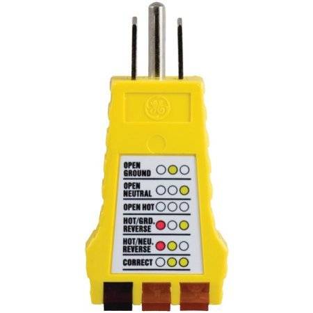

Would sticking the end of a wire in the ground prong of a outlet ground whe wire and whatever is connected to the other end?
Yes. A banana plug connector (male end) often works well for plugging into the Earth ground connection in the US-style AC mains receptacle.
http://www.leadsdirect.co.uk/wp-content/uploads/Nema-5-15-Mains-Plug-Wiring-300px.gif
If the outlet is wired correctly and the house wiring is intact.
It's wise to own one of these outlet checkers, around six bucks at Walmart
7066c812-e30e-4cec-a9cb-06de62747e31_1.b7b88c2ef4d078011c59c8985dc26116.jpe
https://www.walmart.com/ip/GE-3-Prong-Receptacle-Tester/16561511
Likes dlgoff and berkeman
