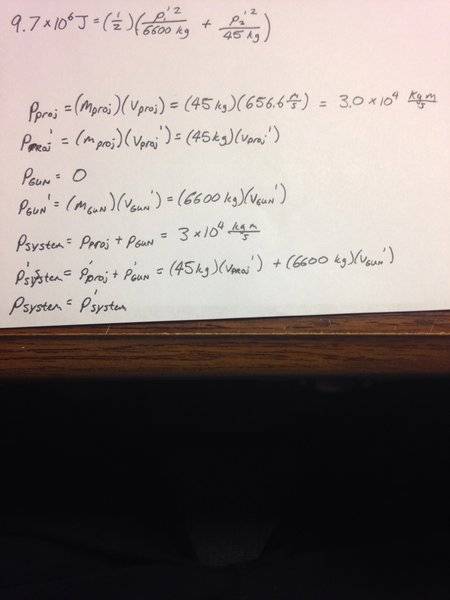

So that's where I'm at now...(ignore that first line at the top)
It looks to me like you are trying to conserve the momenta between the two scenarios... this is not what conservation of momentum means.
In the recoil-less scenario, momentum is not conserved because outside forces are exerted (to hold the gun in place). We don't need to find any variables in this case though, because all the information is given!
In the case with recoil, all forces are taken to be absent, so then the momentum of the gun+bullet will be the same before and after firing.

In that last line you are equating the net momentum of two different systems... why should they be equal??
Conservation of momentum is about comparing a single system at two different times (provided no outside forces act on the system... because that is the definition of force; the rate of change of momentum).
All the algebra in the world won't help if the physics isn't right.
Likes scottdave and jbriggs444

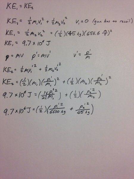

The mechanical energy supplied by the explosion of the gun-powder in the gun is the same in both scenarios. The momentum is conserved during the shot, but the system is the earth+gun+projectile in the first case, and the gun+projectile in the second case. You can use conservation of momentum in the second case (total momentum is the same before and after the shot) , and you get the energy of the system from the muzzle speed in the first case.
Likes berkeman
So far so good?
So wait, if the total momentum is the same before and after, wouldn't it just be zero? Because I thought the momentum before the shot would be zero because nothing is moving.
Calvin Pitts said:
So far so good?
Yes. Now you write the relation between v1 and v2 using conservation of momentum. And yes, the total momentum is zero before the shot.

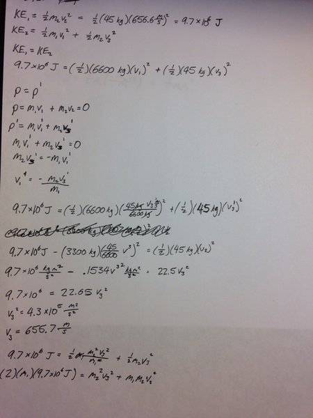

So then for the momentum after the collision, I would have an equation looking like:
m(sub1)v(sub1) = -m(sub2)v(sub2)
Yes. m1v1= -m2v2.
(Use x2 and x2 for subscript and superscript)

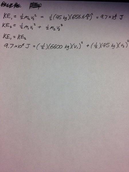

So long story short, I think I finally figured out the answer (with much pain and agony). From that last equation you put in, I solved for v1, plugged that equation in the kinetic energy equation and solved for the new velocity of the projectile, which came out to be 655.7 m/s. Seems like a valid answer. I definitely won't try to type out the work because the app doesn't support the math functions, but should I post a picture of my ugly work? Haha just thinking for future people who might stumble across this thread or for myself to see later.
Just post a picture of your work, ugly or not, it is useful. :smile:

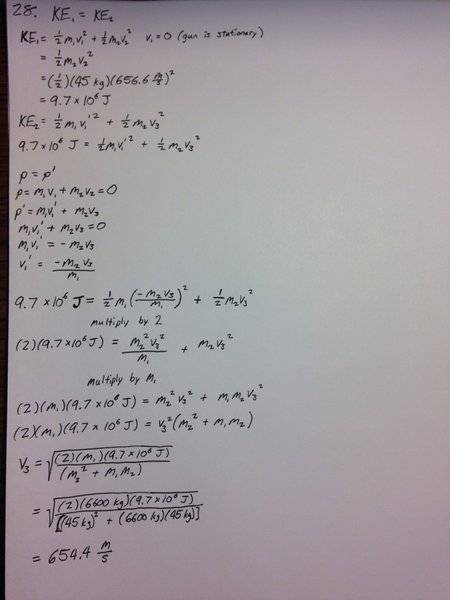

I'm rewriting it now so it's a little cleaner :) I also rounded off a bit for that first time. I'm simplifying the equation in terms of variables right now so I can just go straight through with no rounding. I came up with 654.4 m/s.
Thanks to everyone for the help. I really like this little physics community :)
Likes berkeman
The result is correct, although I can not follow your notations. Sooner or later you learn to type in the Maths.
