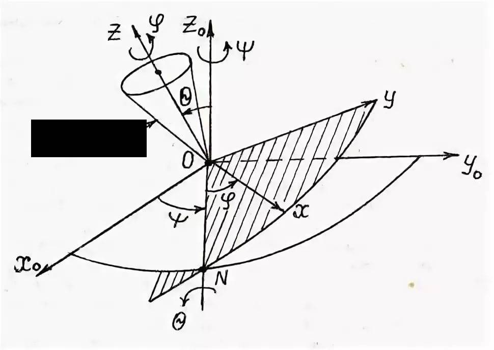

if the body has axial symmetry then we can introduce the Euler angles such that
here x0y0z0 is an inertial frame;
θ the angle of nutation
ψ the angle of precession
Likes vanhees71 and etotheipi
