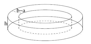

Consider a toroidal coil of rectangular section of N turns, for every one of which circulates a stream I. The inner radius of the coil is a and b is the exterior and the height is h. The core of this coil is a material inhomogeneous in such a way that their magnetic permeability just depends on the angle theta in this way
[tex]\mu o=(1+k cos\theta)\mu[/tex]
vector magnetic field H ?
Please, can u solve this?? I can´t find the answer...
Thanks,
José
Well, I know
H must be variable because [tex]\mu[/tex] is variable.
H=B/[tex]\mu[/tex]
So B is variable but B also depends of [tex]\mu[/tex] and r
For me B is:
B=([tex]\mu[/tex]*I*N)/(2[tex]\pi[/tex]r)
so
H= (I*N)/(2[tex]\pi[/tex]r)
This mean that H don't depend of the center material of toroid
Actually, for a toroid, B= (u0*ui*N*i)/(2PIr)*[ln(rb/ra)] which makes me think that H is really H= N*i/2PI(rb-ra)
