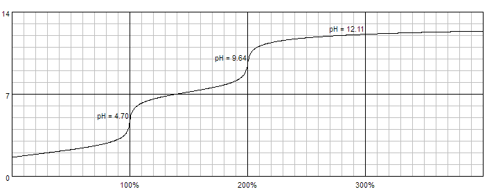

I am not convinced your calculation of equivalence point is correct. You have a solution of an amphiprotic salt NaH2PO4.
This is about shape of titration curve - is there only one, or two separate equivalence points? Once you know equivalence point pH you should check how much of the H2PO4- is neutralized at this pH. If almost none, that's OK, if too much - there will be no well visible, separate inflection points.
Actually there are two, see the titration curve.
Is the definition of equivalence point not: moles of titrant=moles of analyte?
If so, then all H3PO4 becomes H2PO4- which will now act as an acid.
It also acts as a base. And pH at the first equivalence point is definitely not 3.94 that you calculated.
I read the article you linked. But, we never saw those kinds of formulas in class! What would I do to get that 4.70?
http://www.occc.edu/clvahlberg/documents/chem1215/Unit%204%20-%20Equilibria/phosphorc%20acid%20eq%20points.pdf
These guys did it similarly to me. Are they wrong?
Not sure what the question is - just use formulas derived there. There is even a table that shows how the accurately calculated pH differs form the approximated result calculate with the derived formula exactly for your solution.
Unfortunately yes, they are wrong. Theoretical pH at the first equivalence is 4.70.
